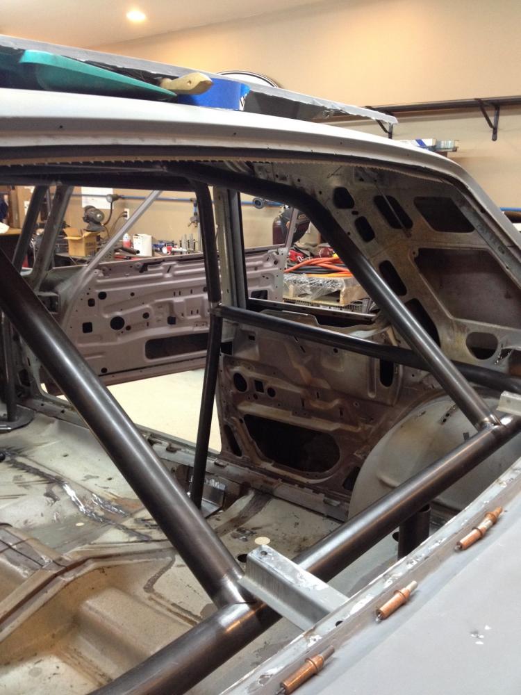

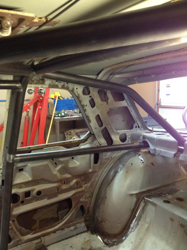

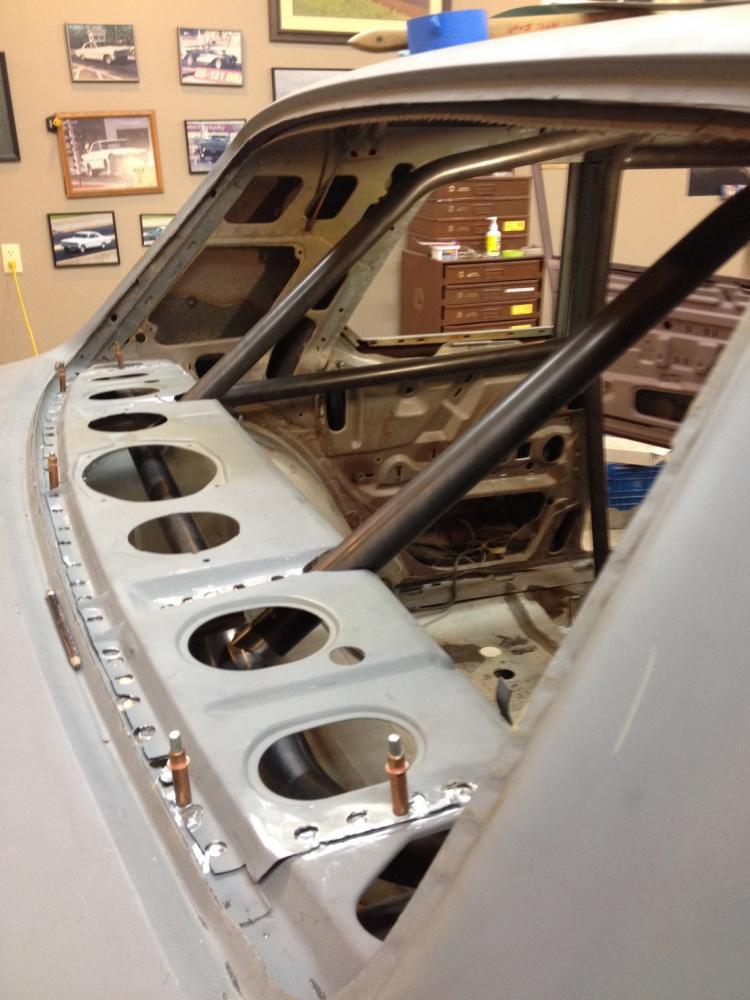

Rear horizontal halo and down bars

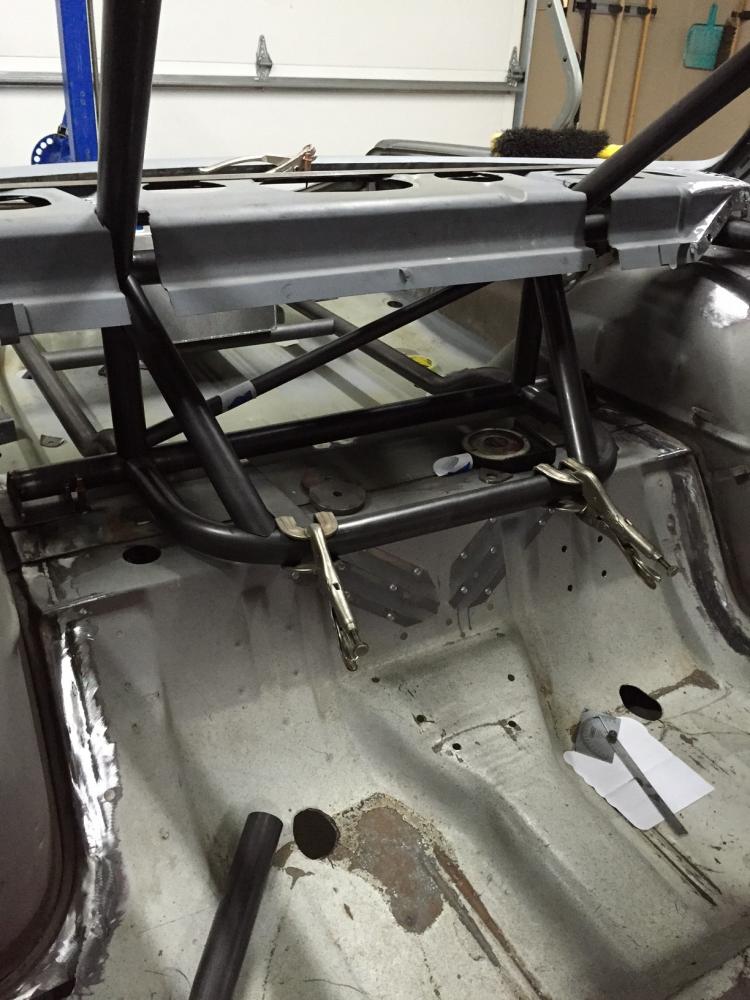

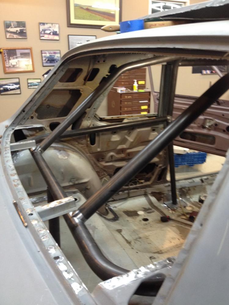

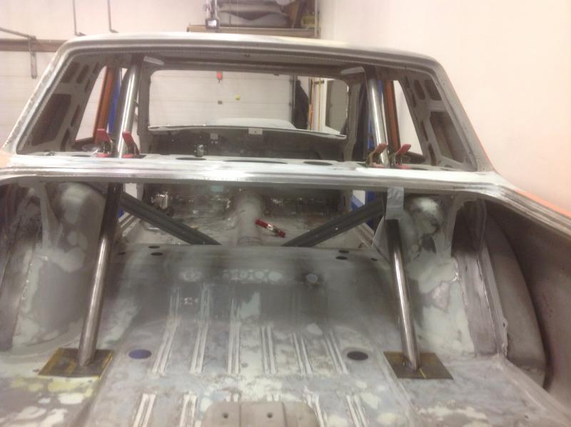

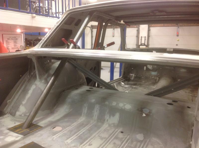

Looks good keep your down bar angle to less than 45 degrees to pass tech
I'm at 44 degrees, just under the wire. You have an excellent body to start with. Exceptional. Keep the build posts coming! image.jpg
I'm at 44 degrees, just under the wire. You have an excellent body to start with. Exceptional. Keep the build posts coming! View attachment 226084
Great thread guys. I am thinking about putting a 6 or 8 point in my 65. Where (and how) do you measure the 45 degrees on the down bar. Is it measured down from a horizontal plane at the main hoop?
65, I put a 44 degree bend into my down bars when I was making them. I'll be running the rear seat and wanted max headroom (cause the 2 grand sons will be jumping in like old Rover used to into the back of the Merc). The bars also slightly drop coming off the main hoop, about a degree. I'm going with swing outs on both sides and I chose a pair of Procar rally low backs over the split bench. I think that it should all work out. image.jpg
I was incorrect on the 45 degree bend. The rear bars must be at a 30 degree or more angle.

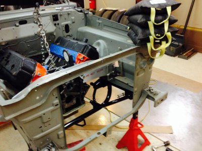

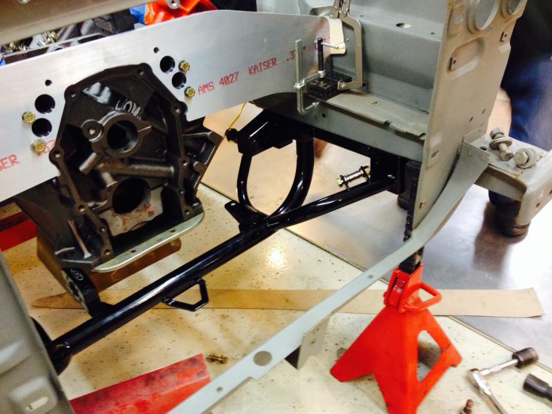

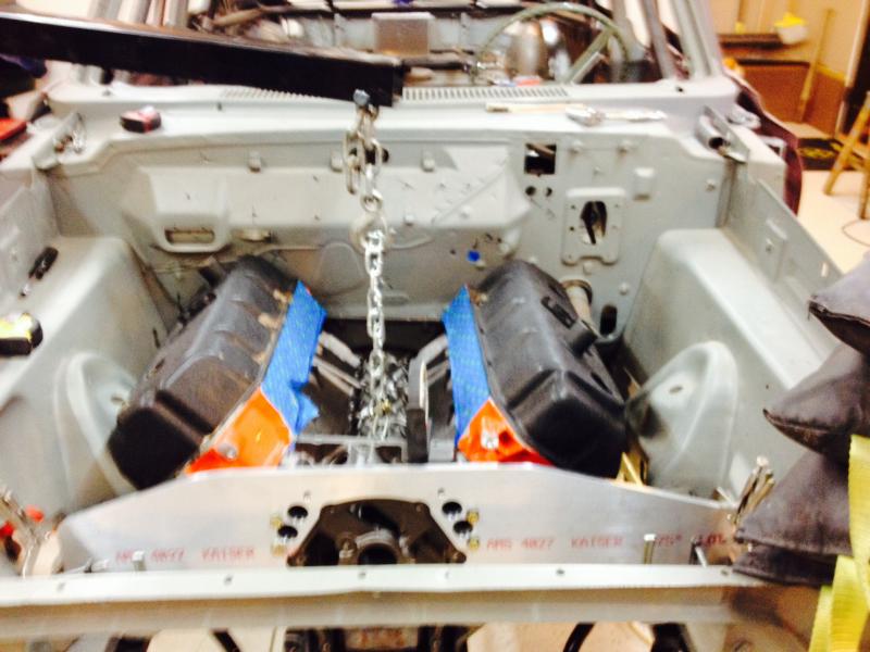

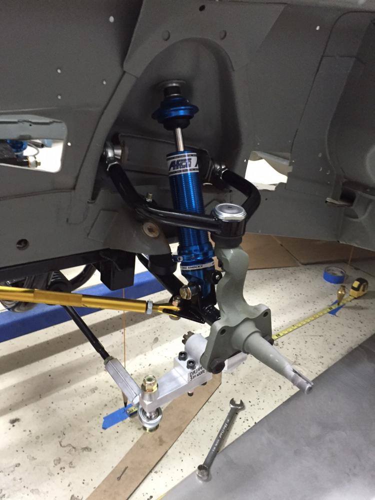

Engine/ K frame/ fuel system mock up

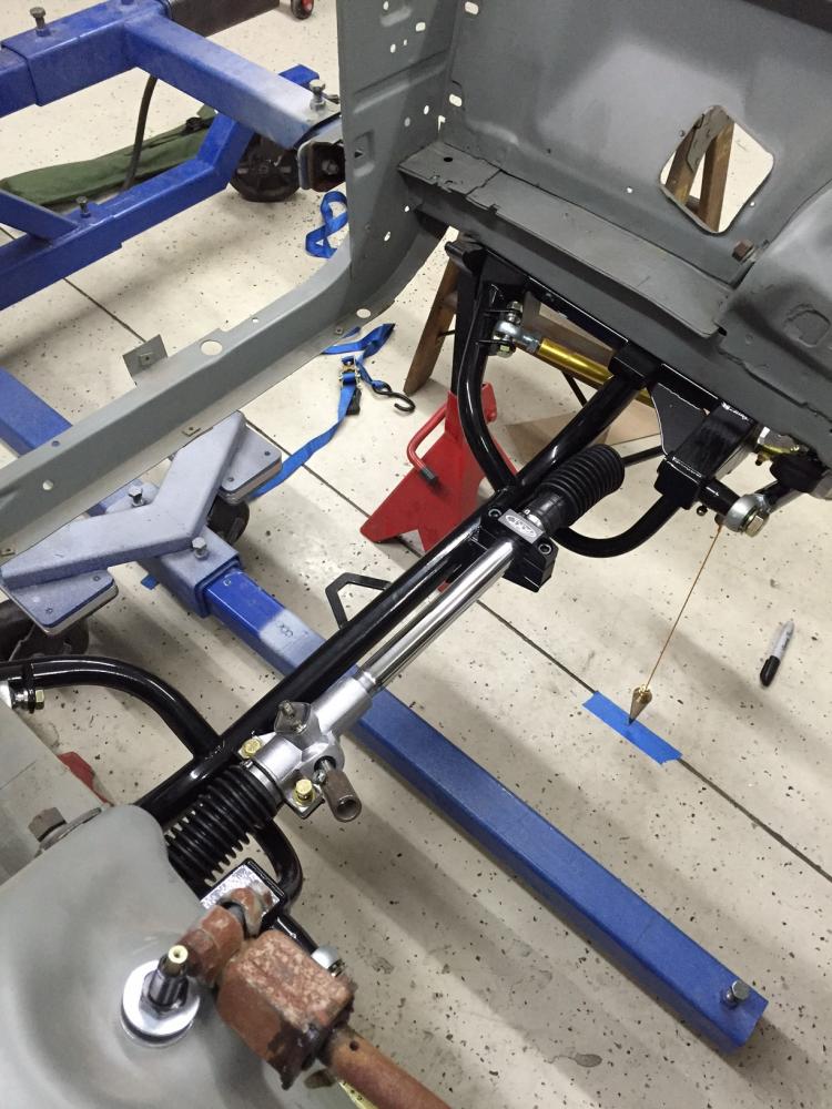

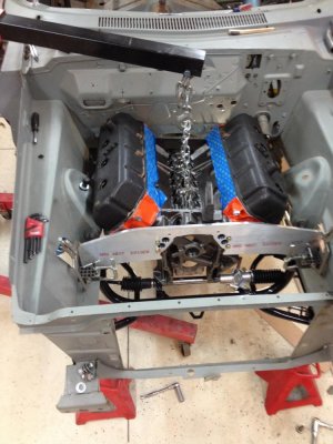

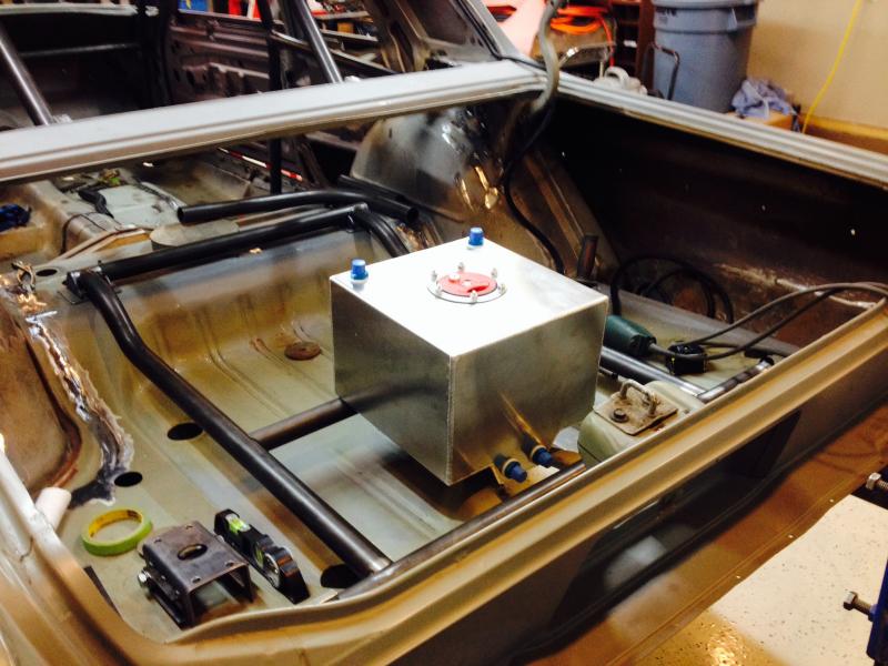

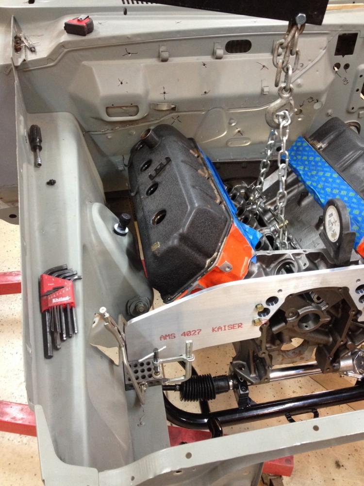

Test fit the mock up engine and set the engine placement today also mocked up the new front Bondo Bob coil over front end suspension. Also got the fuel cell and started the mock up process.IMG_0590.jpgIMG_0591.jpgphoto 1.jpgphoto 2.jpgphoto 3.jpgphoto 4.jpg

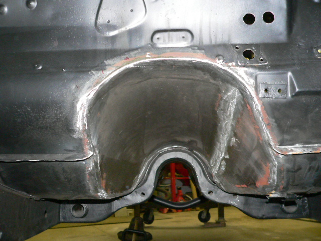

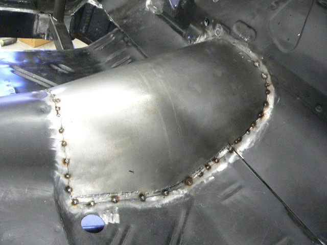

Pretty Zoomie. I'd suggest enlarging the trans tunnel, it is very tight. N/SS Racer says the hemi covers are hard to remove with the Afco adjusters. Are you going to cut the RF shock tower? Here's a pic or the original cut. Lowers the top of the shock and gains clearance. Search this tread for better pics of the tower.
"original 64 hemi shock tower"
Doug

nice build. 64 and 65 b-bodies are my favorites. I noticed in the very first post you said this car was going to be a hemi super stock car. will it be for nhra or a nostalgia super stock racing?. I also noticed you are using a rack and pinion. I was wondering what class can you run the coil overs and rack and pinion in?. is it legal in nostalgia fx classes?. it seems almost anything is legal in the fx classes.(lol!) I don't think it would be legal in nhra super stock. looking forward to updates on the build. I watched dvw's build and stole a few of his ideas and used them on my 64 330.
The car should be legal for FX nostalgia SS. We are building it for fun and to bracket race it also. Shooting for 8.50's. Going to run a 9 inch and a turbo 400 transmission. Engine will be a all aluminum Hemi with a sheet metal fabbed cross ram intake all motor no power adders
No rack and pinion in N/SS F/X
This is from the national N/SS rules which NMCA follows. I'm sure there are other places that will let it slide though.
STEERING: (F/X Classes) OEM or aftermarket steering in stock location mandatory.
Doug

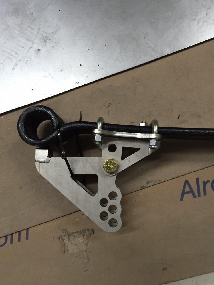

More progress on the 64

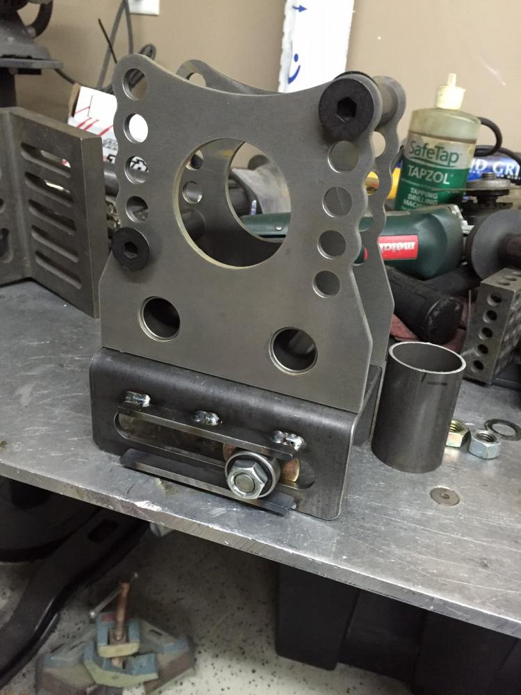

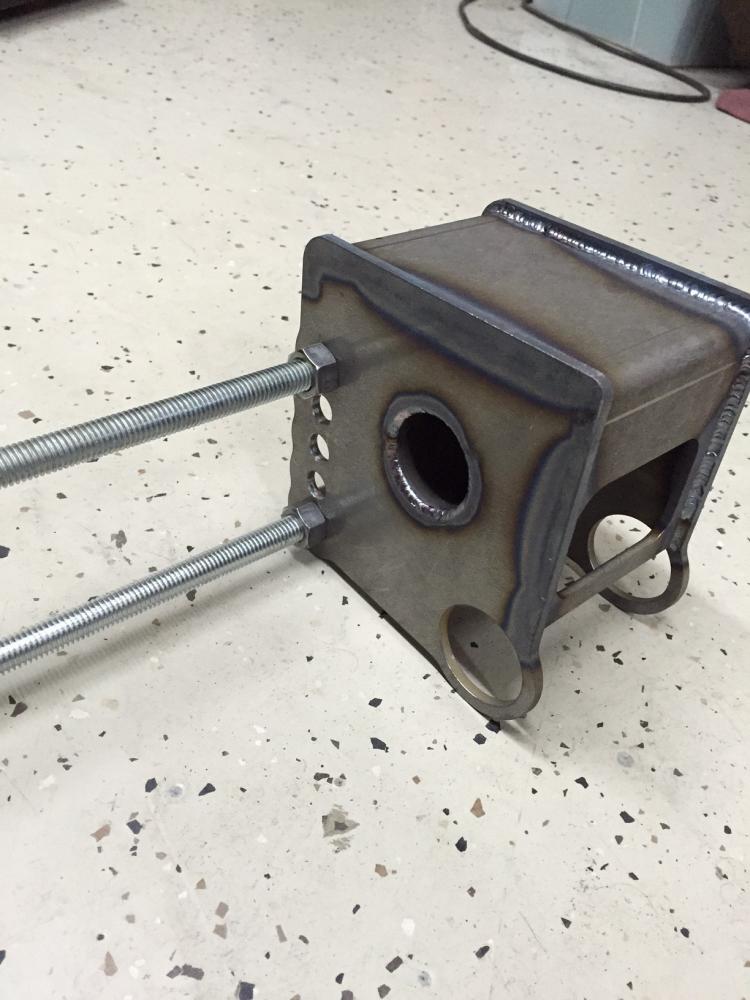

Working on the rear suspension and mocking up the front suspension. Keeping with the leaf springs with rear sliders totally adjustable. Got the 9" Strange rear end ordered and brake package should be here in a couple of weeks. Have the aluminum door hinges (cast aluminum) made and being finished machined. They should weigh 1/3 of the steel ones and will look like the stock hinges Things are moving along IMG_0612.jpgIMG_0609.jpgIMG_0614 (1).jpgIMG_0613.jpgIMG_0615.jpgIMG_0616.jpg
