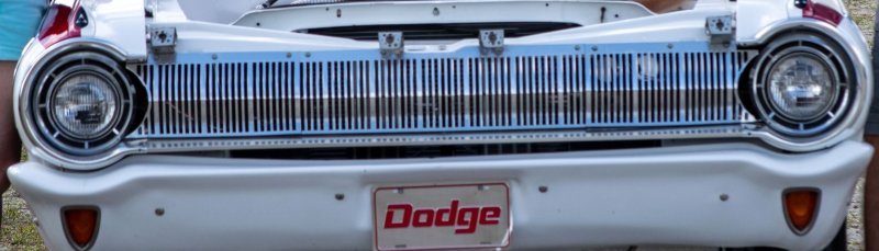

Here is a pick of my grill. It is definitely made from two grills. You can see 3 bolts from each side where the outer sections of one grill were added to the inner section of another. The radius of the light cutouts does not match the head lights, but would match the inner lights on a car without the inner lights removed. The grill is in 3 pieces and just screwed together to the core support.
That’s not how I make the Dodge Polara Super Stock grilles. I weld them.
ksurfer2: Thank You for the information and the picture of Your 64 Dodge. When You get some free time I would like to see a picture of the rest of the Car. From what I see it looks awesome. Again, Thank You - Sir.
khryslerkid: Thank You very much for this picture. I saved it. I am new to this site. I will have to figure out where to go to see the saved photo's. I suppose I need to go to the area where You introduce yourself. I will do that when I have time. My brother and myself each want a 64 Savoy. He wants Red only. I personally like Black or Red even White. So glad You shared this Photo. Well - Thank You very much - Sir.
Hello 5.7hemi: Thank You for your response. I have a question ? You said You weld them. I'm assuming You TIG weld the grilles. Am I right ? When I was a lot younger I could TIG weld aluminum fairly well. Haven't tried to in years though. I think it would be hard to gas weld them. But maybe MIG would work. I haven't MIG welded very much in my lifetime. Again, Thank You Very Much - Sir for Your information and chiming in.
You could use a spool gun on a Mig welder, that will do the job. I Tig weld the grilles, and due to the aluminum used back in the day, you can see where they are welded cause of the aluminum tig rod.
