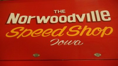

Car is looking cool. Love the scoop. Let us know how it goes at the track. I think you're going to enjoy it. If you don't, give me a call. I'll buy it back!!LOLScott(Norwoodville speed shop) who built the car is from IOWA....I bought the car off the guy he sold it to in York Pa...I know it was raced in iowa...I am sure he will see this current posting and comment at some point.I had the car lettered up and asked his permission to use his shop on the car since he built it.....give it a little retro 60's race car look....
