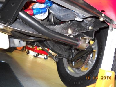

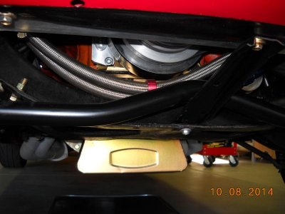

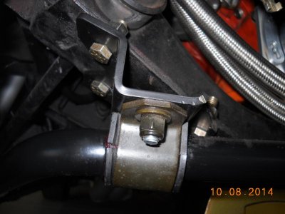

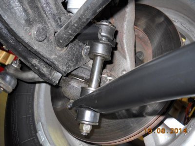

Bit crude looking, but works now for 3+ years on my 64. Paint the pieces black and just enjoy the ride.
What do the installers of the Firm Feel sway bar on 1964 Dodge B bodies have to say about quality?
I installed a Firm Feel front bar on my 63 Fury and am very impressed with the quality and fit.
