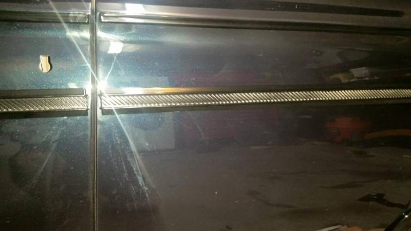

Heres the latest update. The carbon fiber insets are done on the body moldings. It is really hard to get a good picture.
