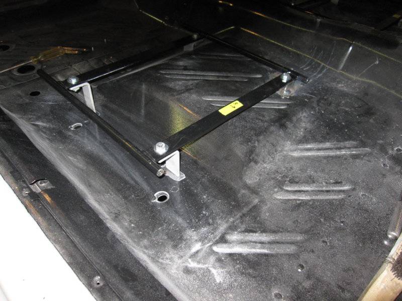

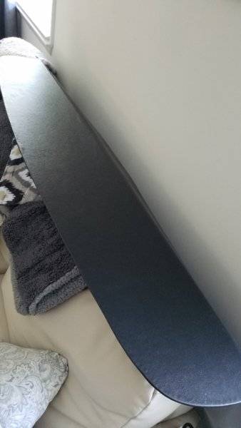

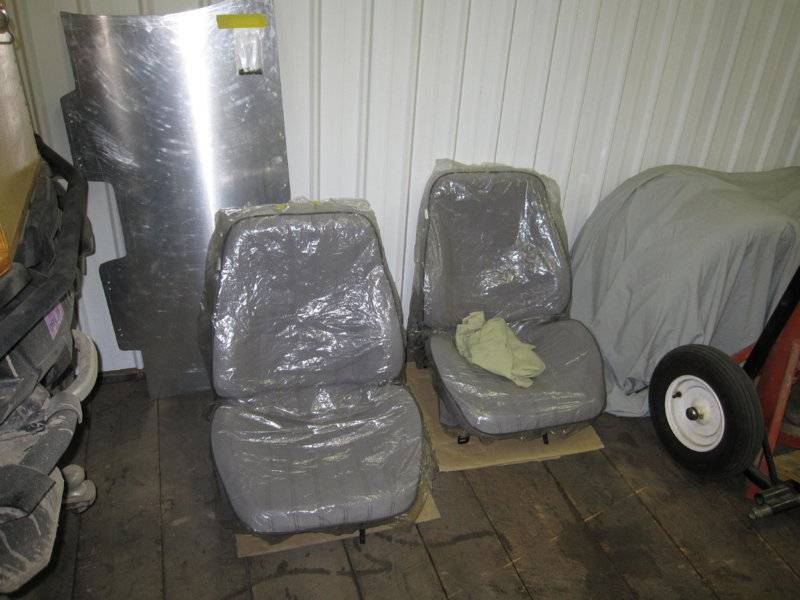

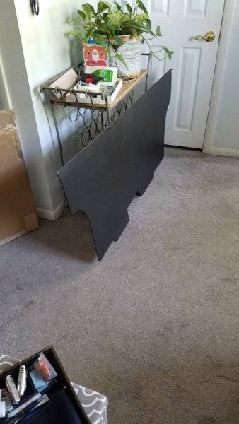

Just got door panels, back seat delete, package tray, kick panels, headliner, and carpet from Gary Ball. Couldn't be happier with the service and craftsmanship. I held off on getting the ss seats and brackets because im still undecided on which seats I want to get. I was checking out the pro car low back buckets, but it looks like they only have brackets for 67 and up b body. I wanted to see if anybody has used the pro cars, and if a later b body bracket would work in a 64? I would love to hear of any other options out there. thanks in advance!
I bought Scat Rally low back buckets for my 65 with their universal mounting brackets. They went in nicely. I used 3 of the supplied brackets for each seat mount with 1 solid block of steel with a tapped hole (block welded to floor) for the front inner mount.

Extremely happy with everything. I shipped the medals from my door panels out on a Monday or Teusday, he got them on Friday, and he had everything done and shipped by the next week. He answered every question I had and there were no headaches. It was about 1600 all said and done, including shipping my medals to him, and getting everything delivered to me in Jersey. He's in Indiana

Wow ,that's pretty quick turn around . Does the rear door panel now go ll the way to the wheel well?. With the back seat out i noticed that the factory one don't, just wondering how he handles that area. Thanks for the pictures, looks great.
I'm not 100% about that, I haven't put them in yet because the cars at my buddy's getting the roll bar done. I'm sure if you call Gary he can tell you. He has a page on Facebook with a lot of pictures of his work too. I do know the carpet has a 6 inch extension for the back seat delete so it covers the whole floor
