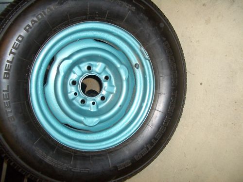

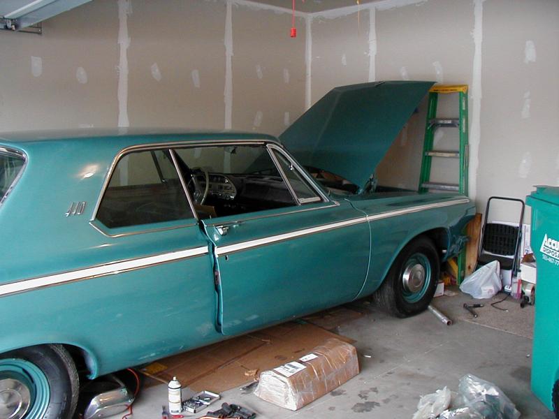

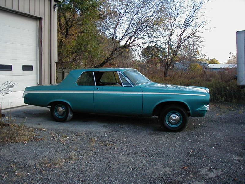

14" are very hard to come by but I was able to pick up a new matched set on rims for $200.00...225 75R 14
