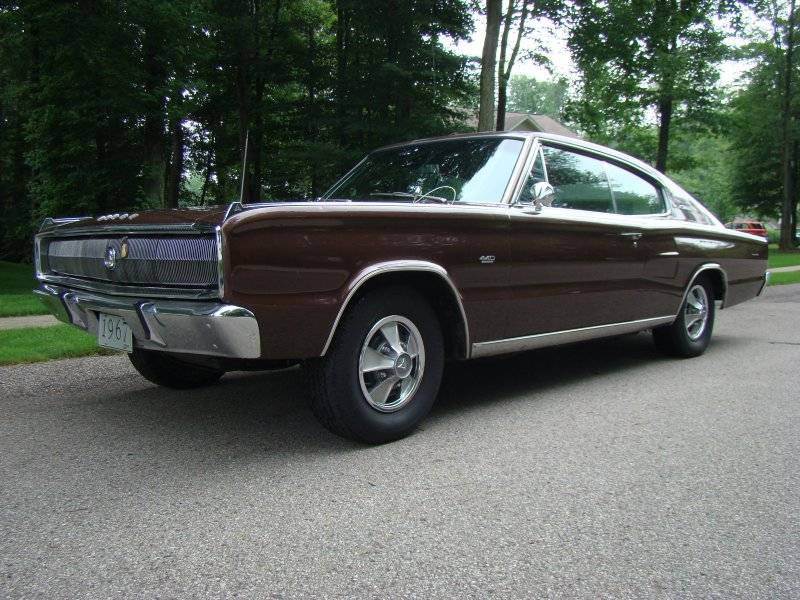

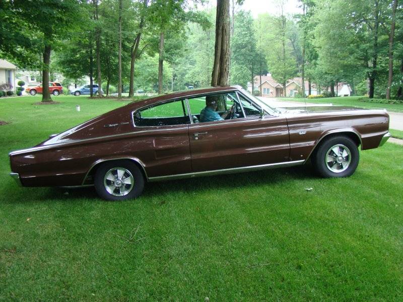

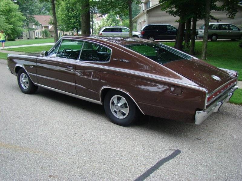

Pics of my Charger with 235-70-14

Pics of my 235-70-14
Very nice Charger. I have not very often seen those "Mag-look" wheel discs on a Charger, given that they already had a special disc. I know they were an option, and my 1967 R/T came with a full set of them in the trunk. My R/T was a 20-year-old car when I bought it. The original engine and transmission were gone, but the wheel discs survived!

Thanks.
Yes, it was an opton. "Deluxe" wheel covers. $21.30
When I stepped up to the 15s, I went to Magnum 500s too. I think it looks good w/ the Magnums, but I miss the hub caps, and they enhanced the sleeper look, IMO. As pictured, the car ran 11.70s at 120.
