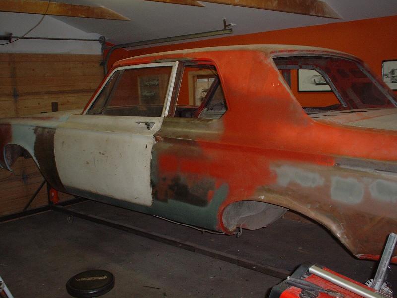

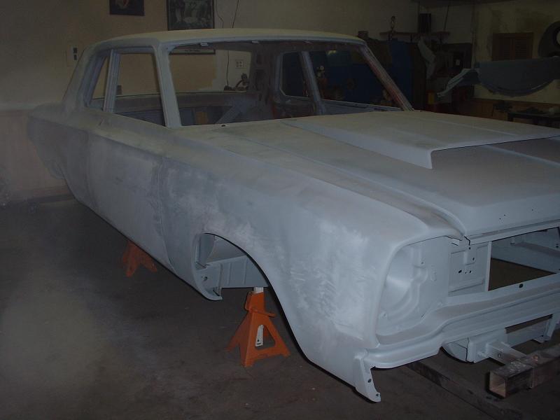

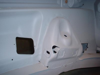

I thought i would try taking some night time photo's of my latest work. So, what do you think ???
Love it!!!
Yea thats looking real good ! Ron
Looking cool so far. I like that body styling. :headbang:
Very nice!

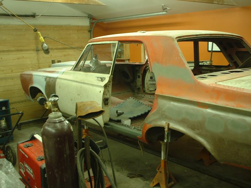

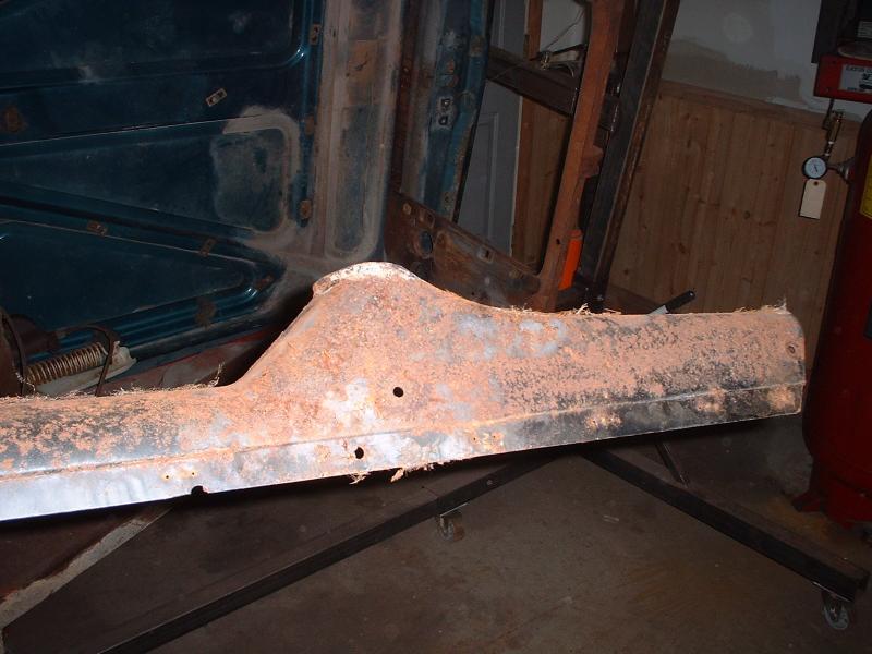

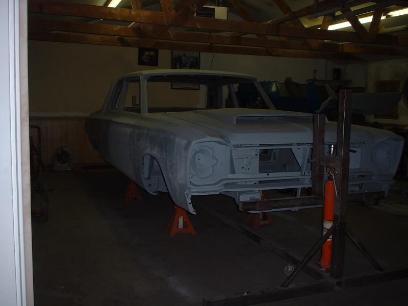

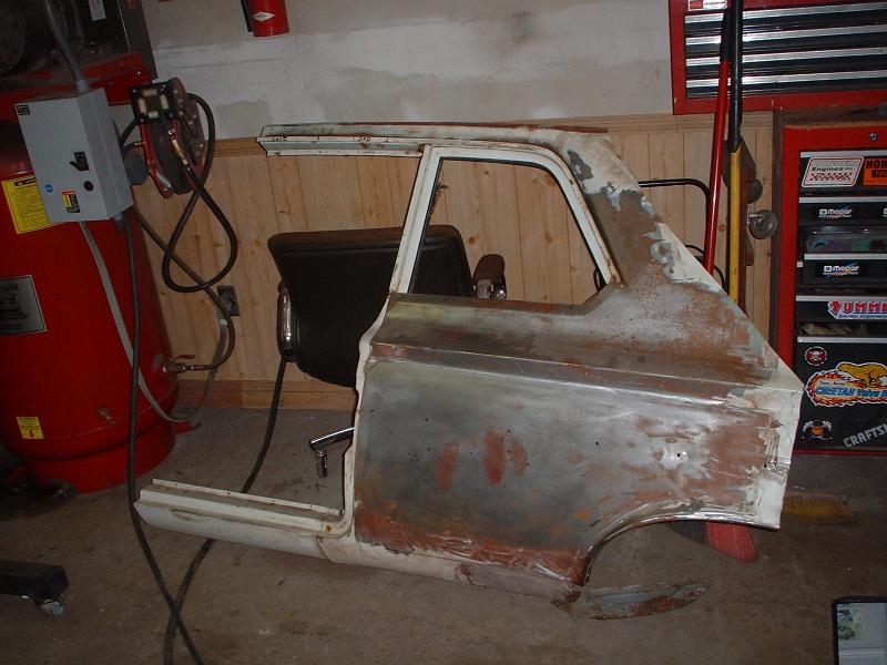

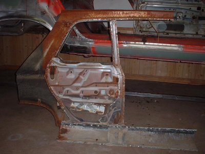

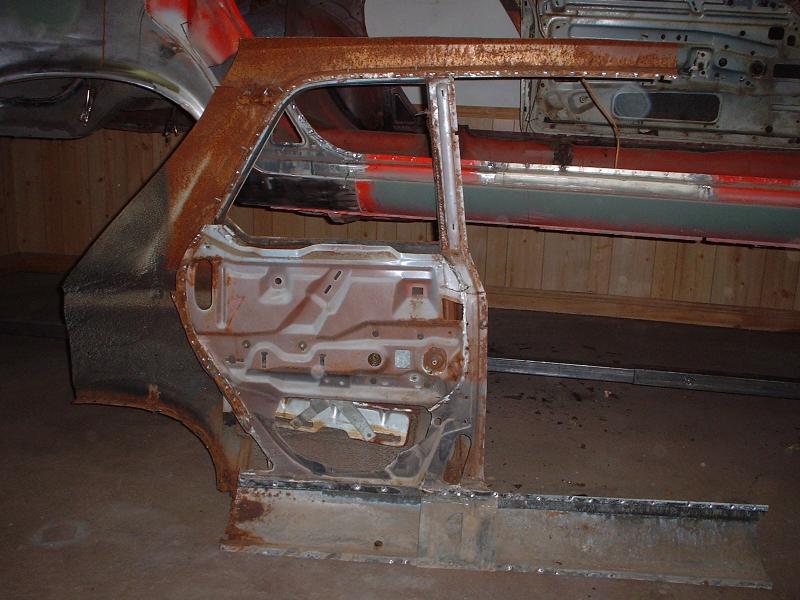

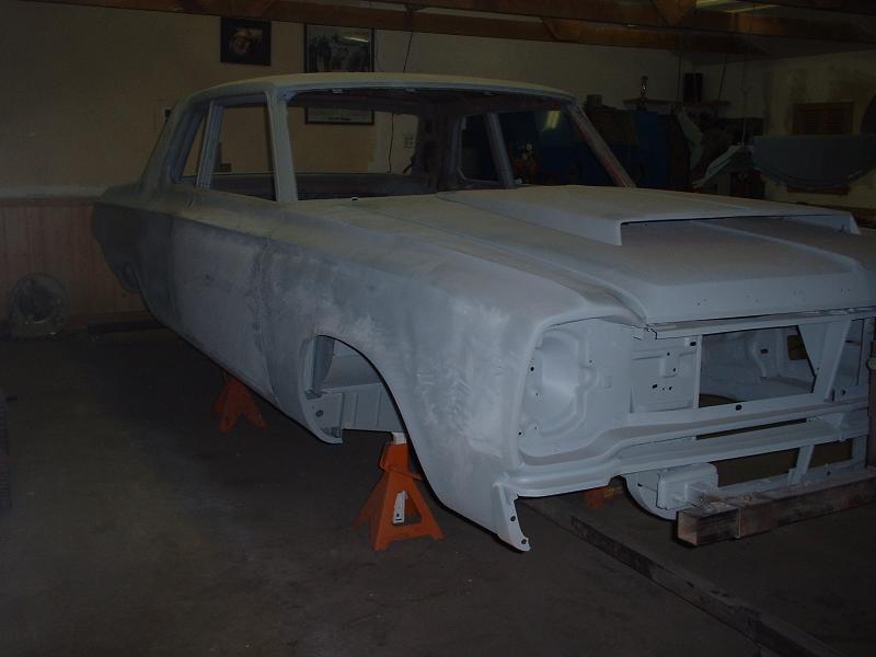

Some quick history on this car/ project. Its a 4dr- 2dr rebody. The sheet metal / parts came from all over the usa. All the parts were bought from e-bay, moparts , craigslist and this website. It's a true "hodge-podge" of sheet metal. Alot of time was spent on repairing , welding ,grinding and bumping out dents. ....Here's some more photo's.
now and then 001.jpg 65 predoor 005.jpg 65 predoor 010.jpg now and then 009.jpg

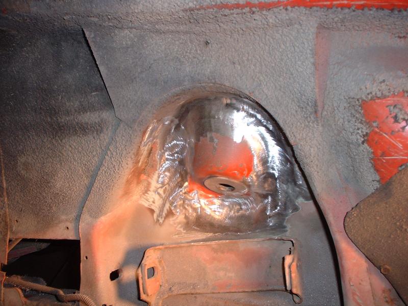

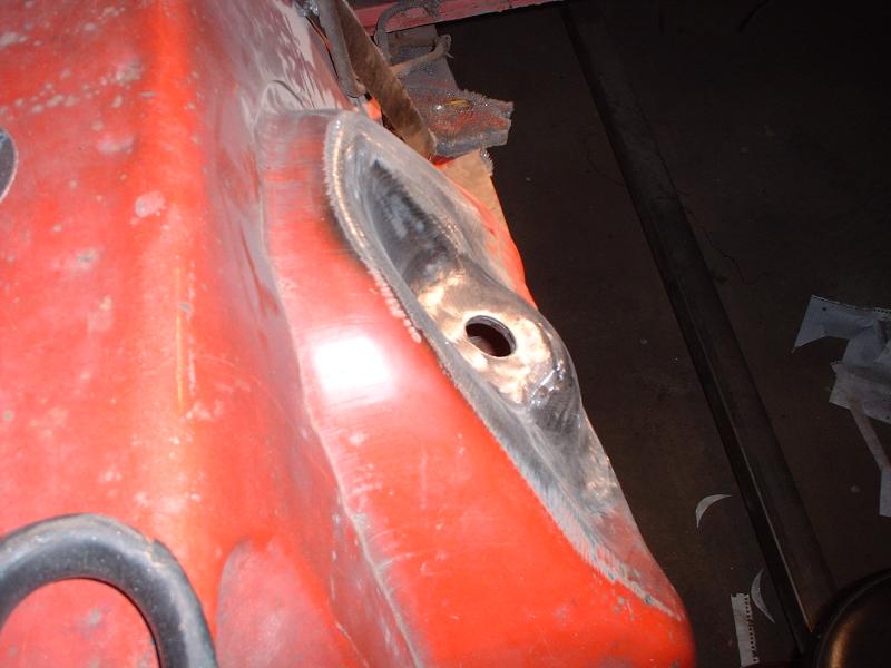

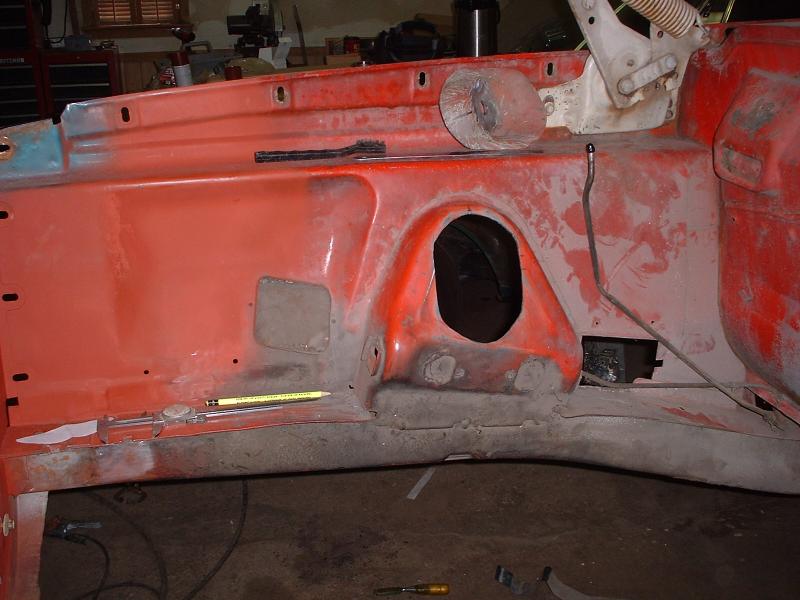

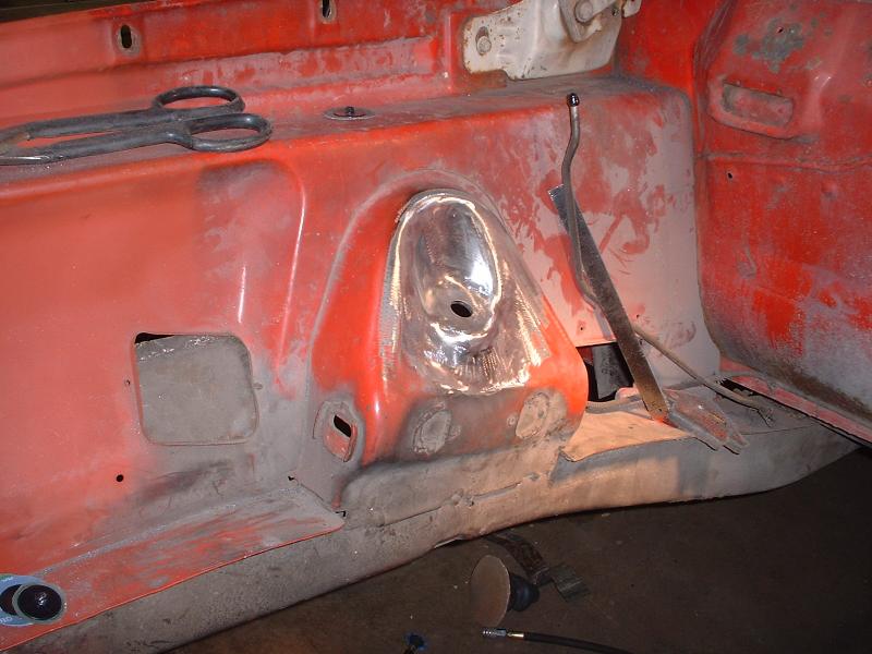

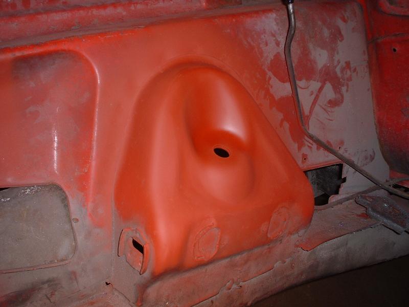

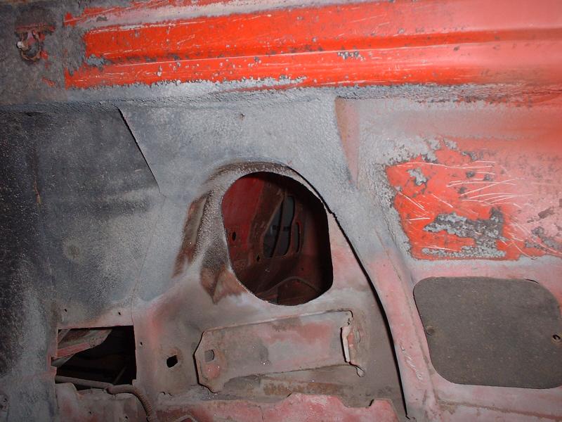

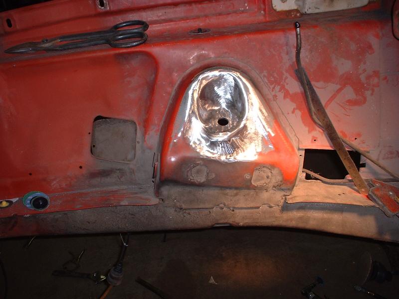

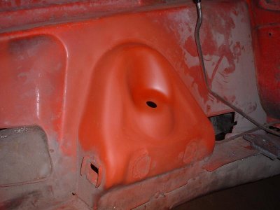

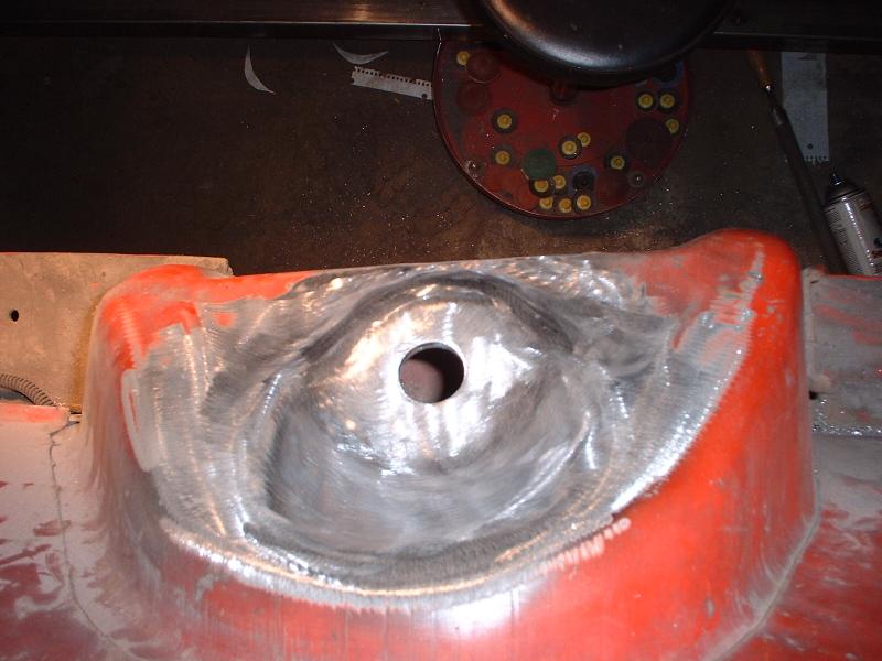

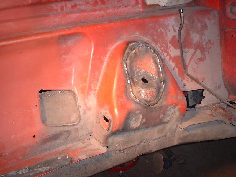

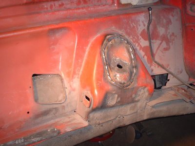

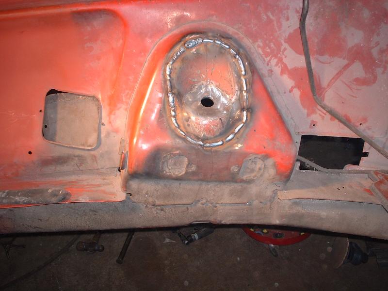

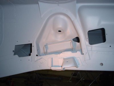

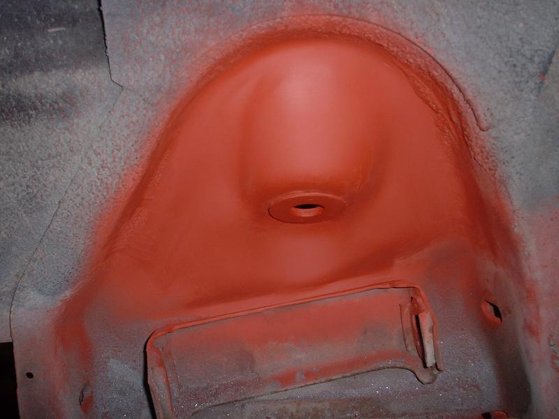

Here's some photo's of inverting the shock tower. Sorry , these are random photo's of the build. Not a step by step of the car project.
hemi head cast number 003.jpg65 shock tower 001.jpg65 shock tower 003.jpg65 shock tower 017.jpg65 shock tower 018.jpg65 shock tower 019.jpg65 shock tower 020.jpg65 shock tower 021.jpg65 shock tower 022.jpg65 shock tower 024.jpg65 shock tower 025.jpg65 shock tower 027.jpghemi head cast number 002.jpg
hemi head cast number 003.jpg 65 shock tower 001.jpg 65 shock tower 003.jpg 65 shock tower 017.jpg 65 shock tower 018.jpg 65 shock tower 019.jpg 65 shock tower 020.jpg 65 shock tower 021.jpg 65 shock tower 022.jpg 65 shock tower 024.jpg 65 shock tower 025.jpg 65 shock tower 027.jpg hemi head cast number 002.jpg

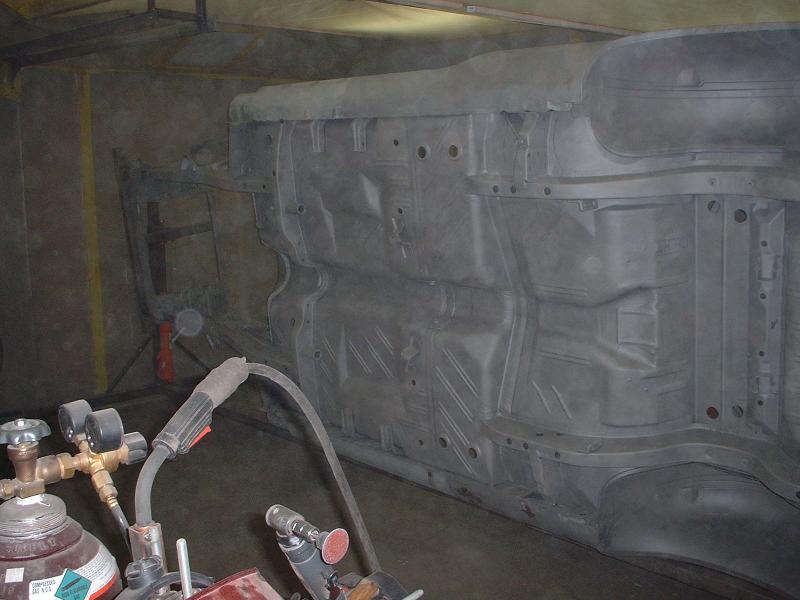

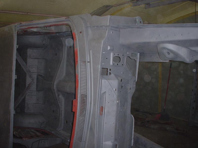

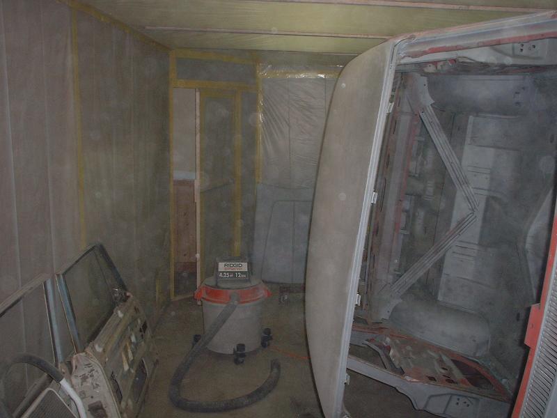

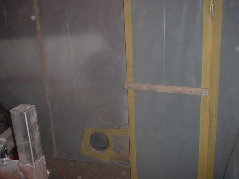

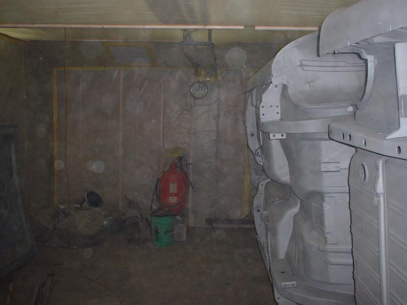

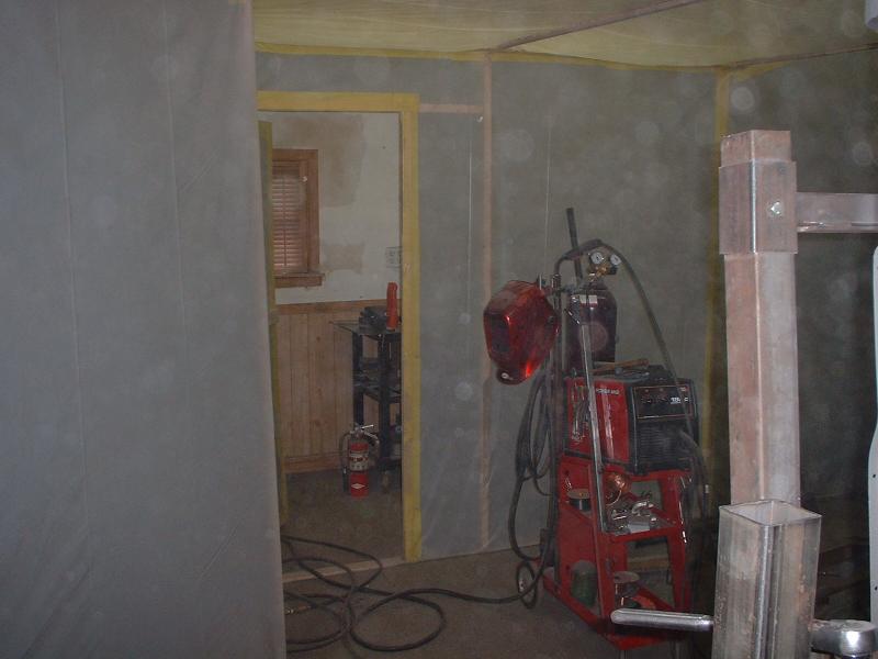

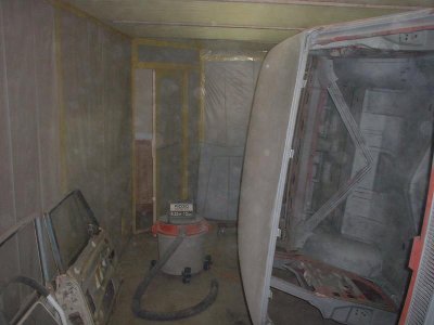

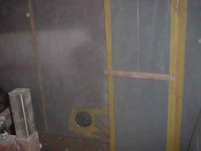

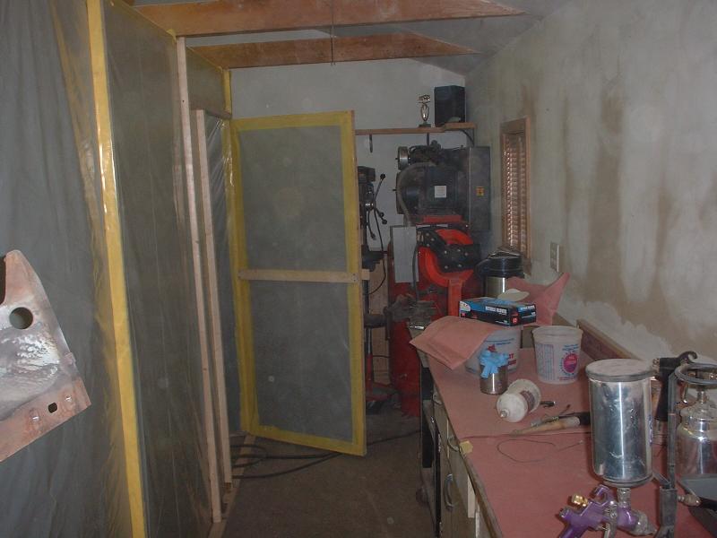

One thing I did that worked out great was, I built a neg pressure booth out of 2x2's , 6mill poly and a home furnace fan. I could sandblast or paint for hours at a time , with no dust or heavy fumes . I did all the blasting and priming this past winter. Heat from running the air compresser , would warm the garage nice. The real trick was keeping the temps even, with all the neg air pressure.

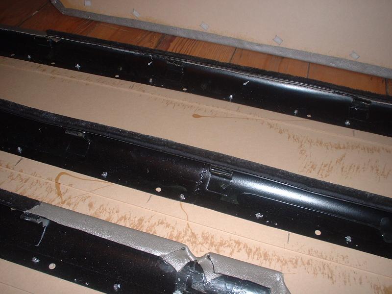

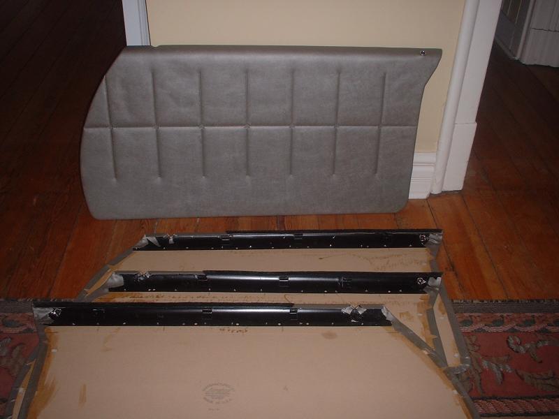

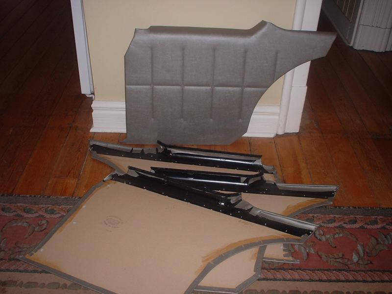

Last fall I sandblasted, epoxy primed and painted two sets of front and rear door panel top's and installed some super stock door panels from legendary.One of the sets of door tops I custom made. The hardest part was finding some lock furrels and knobs , that i was happy with. Joe suchey had some that i liked.
door tops 004.jpgdoor tops 002.jpgdoor tops 001.jpgdoor tops 002.jpgdoor tops 003.jpg
