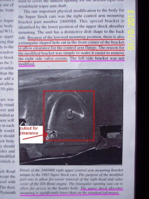

I am working on a 65 belvedere A990 hemi clone. Looking for pictures of the inverted shock tower.Would like to look at a picture before I start cutting.
Thanks in advance!!

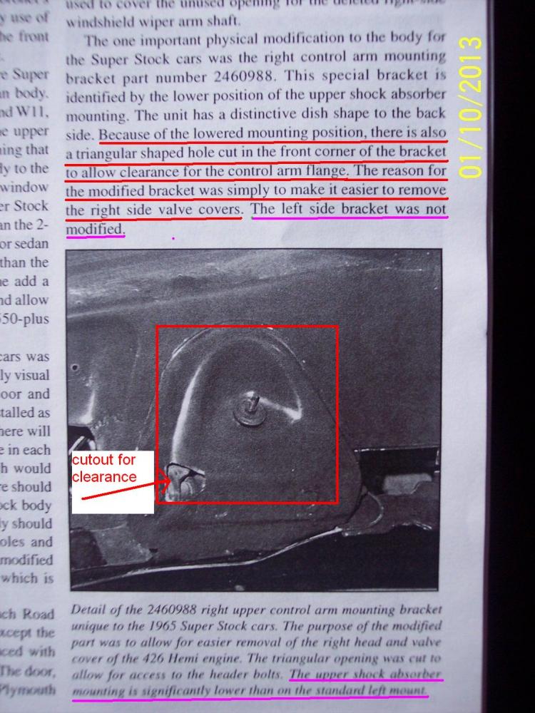

Here is a picture from one of Mosers car.
