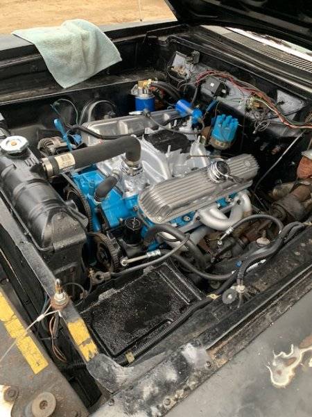

I am thinking of replacing the engine wire harness for my 65 Belvedere wagon. It's a 360 small block with electronic ignition conversion. What brand is good and what should I stay away from?
