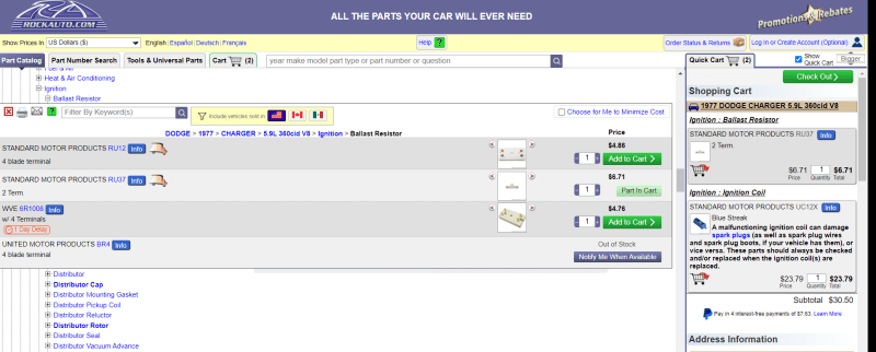

No like others indicated, I would suggest getting another ballast resistor.
I added one on the screenshot along with the blue streak coil.
Look again.
Look again.
Now I see it. I'll try it and see how it goes. Off topic, I also have an Aussie mix rescue. She's my cruise night buddy.
