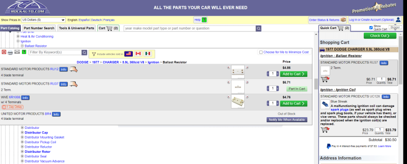

Standard Motor Products Blue Streak was always good quality stuff.
I agree that your current ballast resistor is kinda high it was likely supposed to be paired with a low primary resistance coil.
You can get Blue Streak pretty inexpensively from RockAuto:
I just picked a 1977.
For a little more you can get an AC Delco Gold or Professional (I know GM) but their stuff was always good too.
