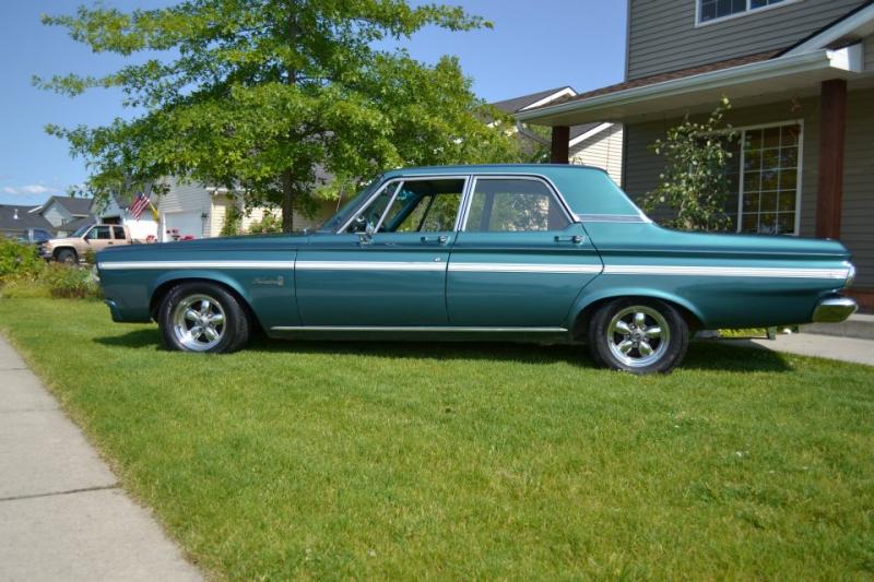

Thanks! Got it three years ago. Inside looks just as good. No rust on the car and only one area in the back quarter that will need to be fixed at some point. Got real lucky on this one for only $2,500.
Slant six ran really well for a long time, but after an oil and coolant mishap, this sucker is ready for some power.
