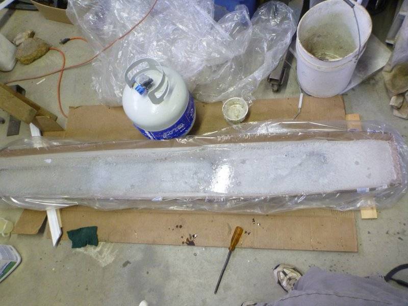

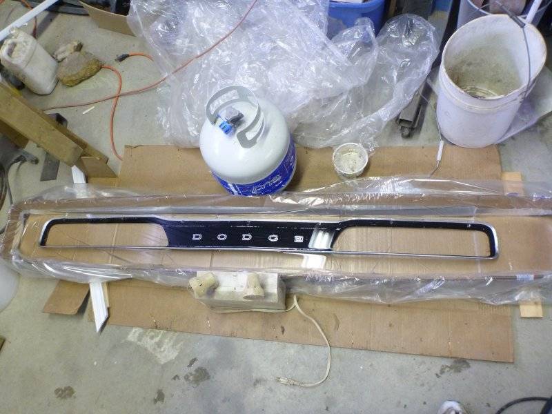

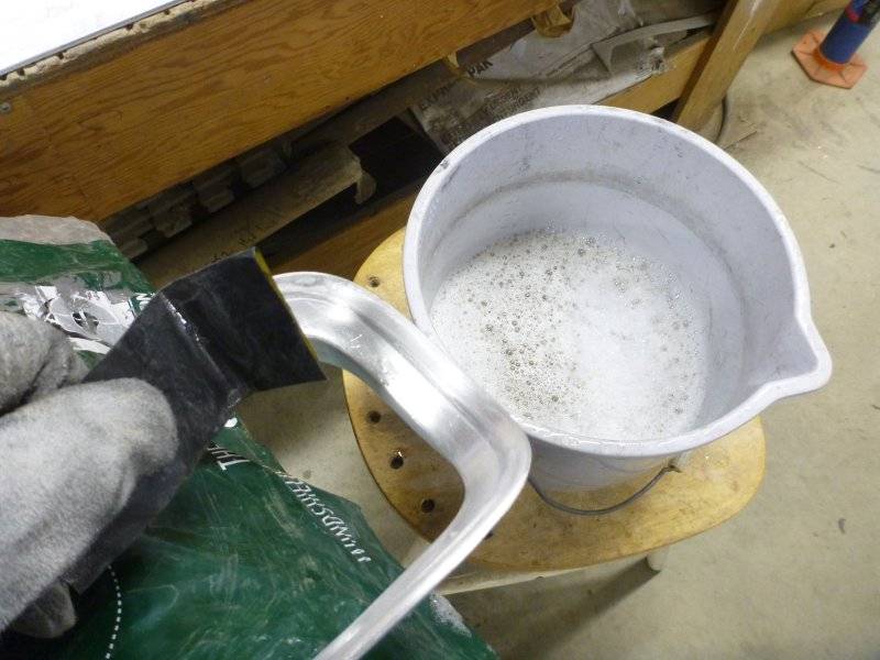

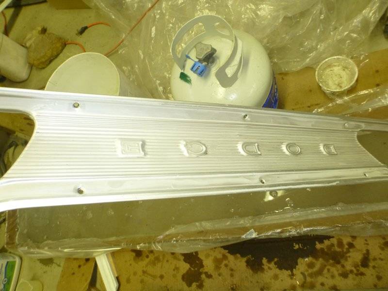

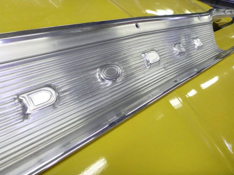

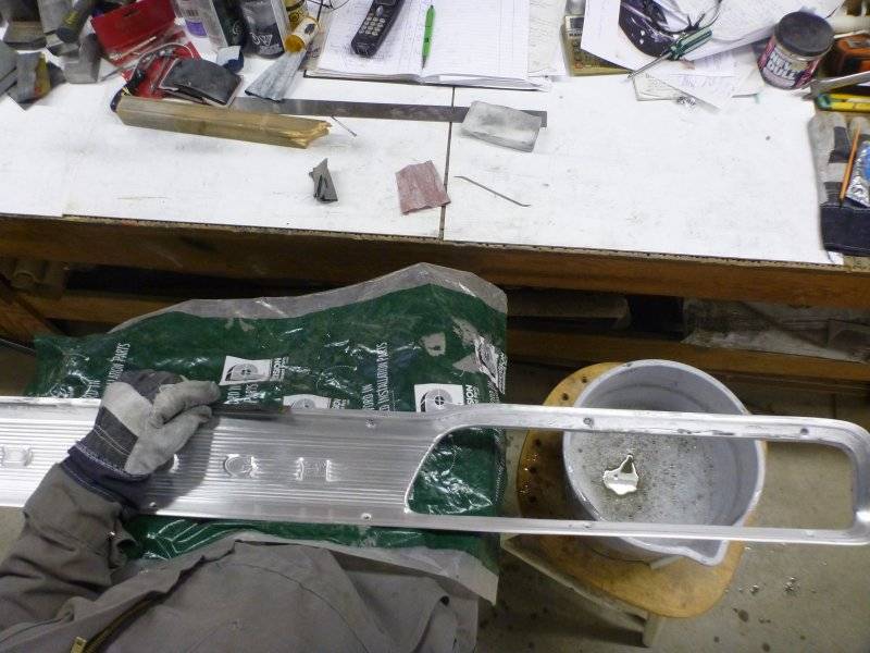

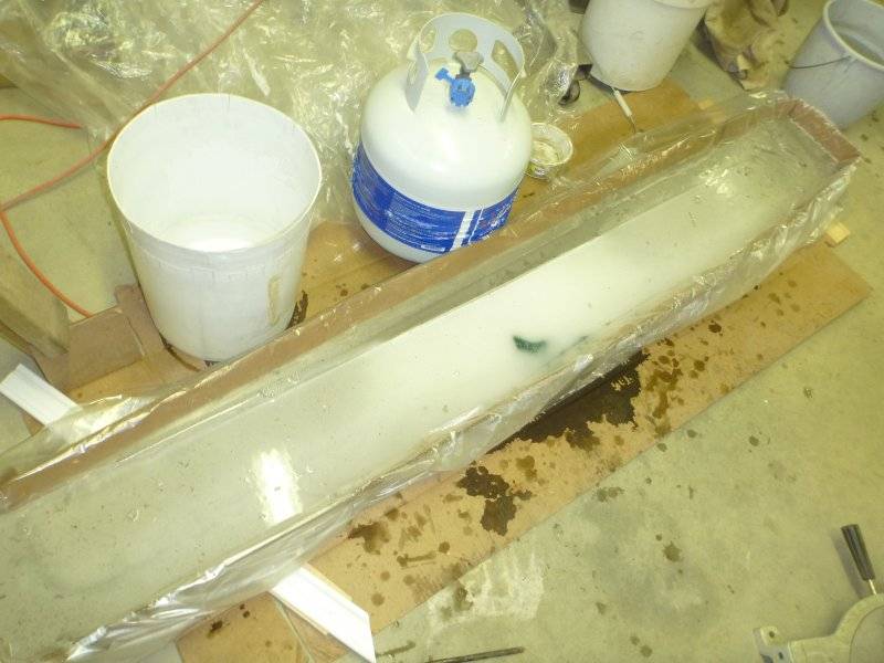

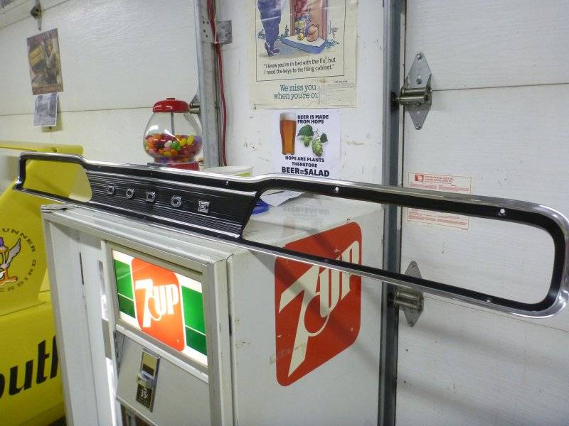

Lye bath to strip and then hours and hours of work. Believe that I put 48 hours into my Bee tailpanel...
