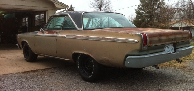

The car itself is a garden-variety 318 column automatic, ps, pb, factory air, tinted glass. I bought it in early 2012 in Illinois. Although the Indiana plate was so rusty I couldn't make out the year of issue, and the passenger quarter panel was pretty wrinkled and rusty, the car was complete and somebody had recovered the seats nicely (not sure why, maybe from another project). Anyway, I thought it was worth rescuing. None of the usual tricks to free up the engine worked, so out it came, along with the rusty floor pan.

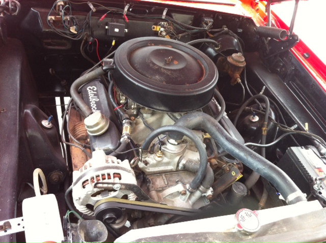

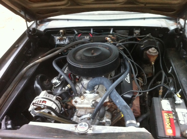

This not being a limited production model, I decided to do this one as a driver. An LA 318 and trans from an '87 Ram pickup went in, after I installed new oil and fuel pumps along with a car oil pan. No, I didn't pull the heads or start it first, I figure a $300 motor is a good buy whether it runs or can be used for parts. I did take the risk, though. I fabricated the motor and transmission mounts from the original poly-318 mounts. New Edelbrock 600, swap-meet intake, new electronic distributor, aluminum radiator, lengthened driveshaft 6 inches for the driveline. Then complete brake rebuild from the master cylinder out....yes, original. The dual-system and discs will have to wait.

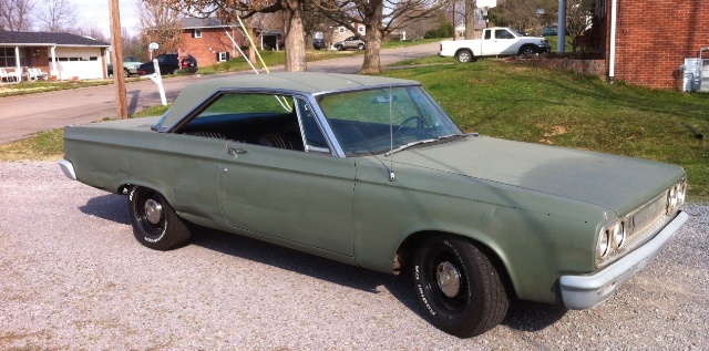

Over to the front-end guy for complete rebuild using Moog parts. Rattle-can army green primer paint to keep the neighbors from complaining about the derelict car (got pulled over in front of my own house after somebody called the cops about a "suspicious vehicle"). Then a 120-mile round-trip shakedown cruise one Saturday afternoon to make sure the investment was paying off.

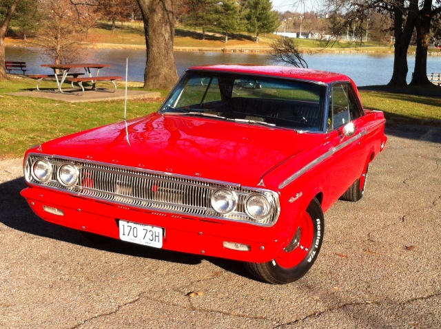

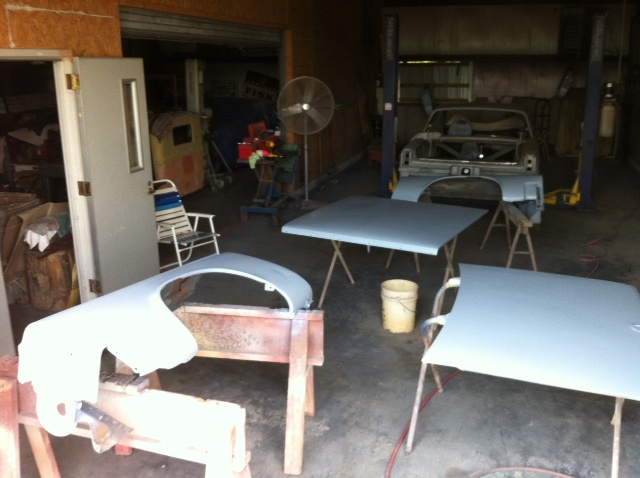

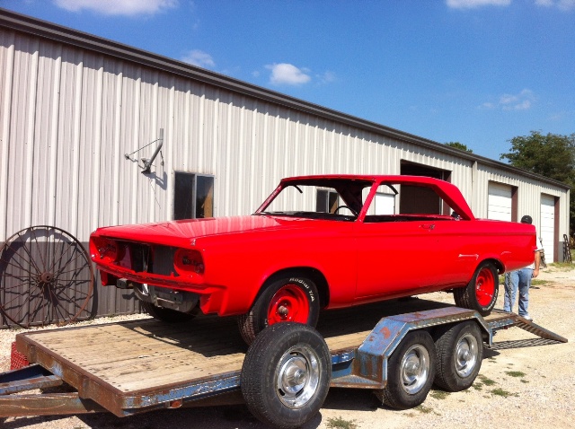

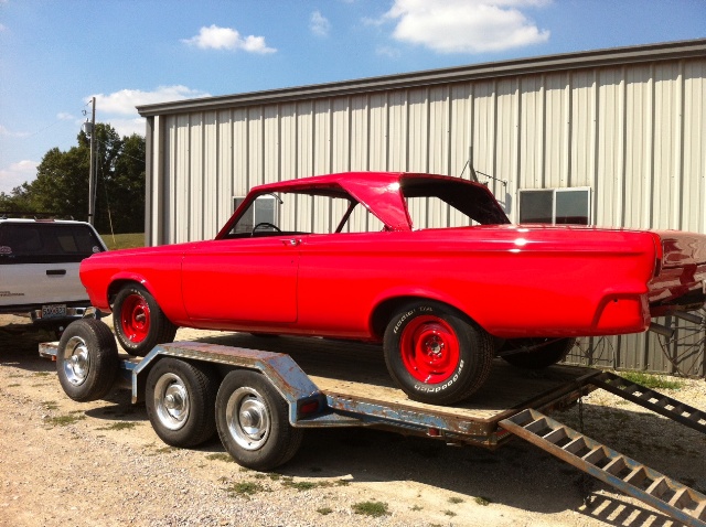

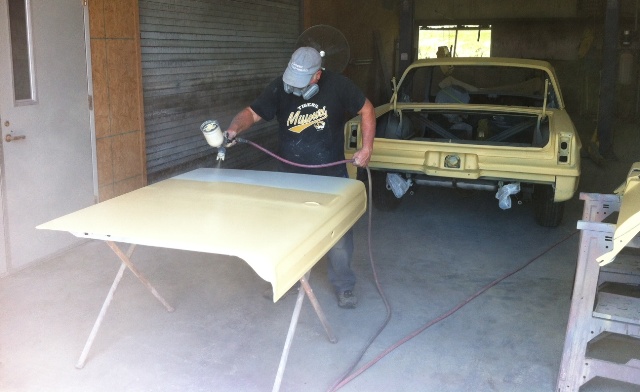

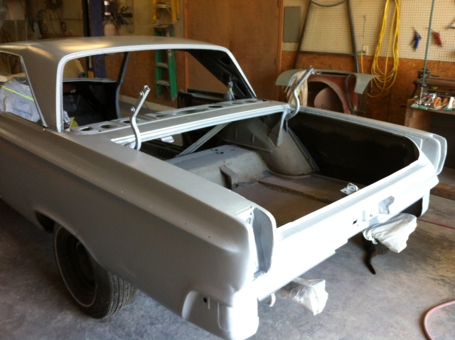

The beginning of June found "Honey Dodger" (my wife says its nasty-a$$ in a good kind of way) in a buddy's body shop. I did the low-tech stuff, such as sandblasting every body panel early on. Now I'm learning the finer points of block sanding. The high-skill stuff is being done by a guy whose previous work is way nicer than what I originally had in mind for this car, but he is working cheap, the car is going to look great, and you can't ask a good body-man to do a crappy job.
The drive line, wiring, and suspension is all staying in place, because that would only complicate the project. Those of you who say "it doesn't take any time at all to take those parts off", I hear you. Again, this car is getting rescued from the scrap yard, not restored for the show circuit. This car will be going on the trailer and back to my garage as soon as the paint is dry; other projects are waiting in line.
