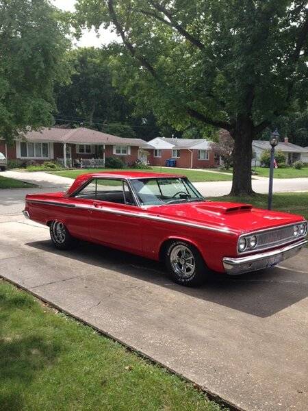

Let’s see some pictures of your ‘65!
Here’s mine:

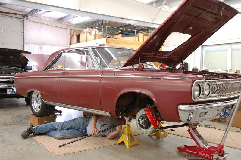

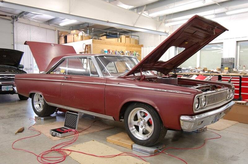

Doctor Diff has everything you need for that conversion. I used a bunch of parts from Doctor Diff to put disc brakes on the front and rear of my '65 Coronet.

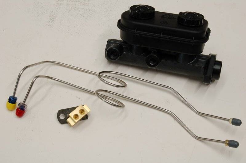

Doctor Diff will also have what you need to upgrade to a dual master cylinder. He carries a dual line conversion kit including the new T block but he might not show it on his website. Sometimes his website is the last thing he works on after shipping orders all day long.
Here is what the dual line conversion kit looks like.

Your car is same color as mine was. What size tire combo are you running looks nice. I have my have ss springs with offset hangers. Want to fit the widest tire possible. Thanks and nice car
Sorry for the late reply.....thanks for the kind words........the rear tires are M/T Sportsmans......275 X 60 X 15s on 15 X 8 Torque Thrust D's. No spring alterations at all and I have about 1" clearance on both sides of the tire. Fronts are 255 X 60 X 15s. Same wheels.....I don't like a skinny front tire w/P/S. You could go wider on the rear I believe.
