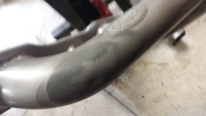

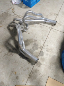

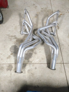

I have a set of HOOKER fenderwell headers 440 A-Body. Ceramic coated. They were used on the dyno only and look brand new except for a few small spots of discoloration. Selling for $650 plus shipping
Thanks, that is very helpful. I looked at Doug's about a year ago and never seen them? I wonder if they dump straight down behind the front wheels? They kind of look like they might ,that's the look I'm looking for. Doug's are usually pretty good quality too. i like the set that I have on my 64 440 Polara 426 Street Wedge 4 speed car.
