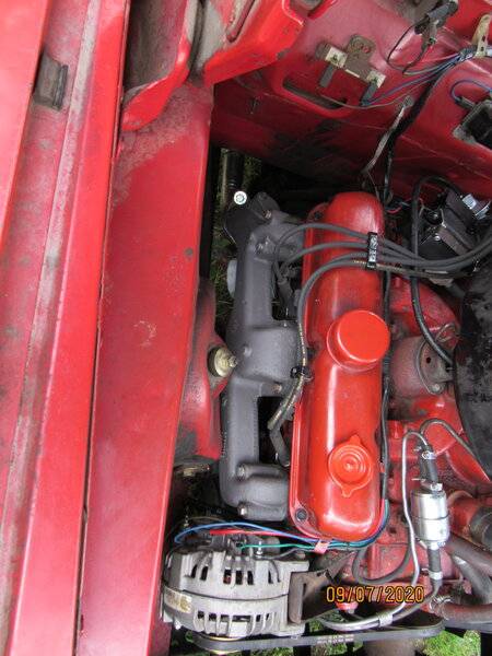

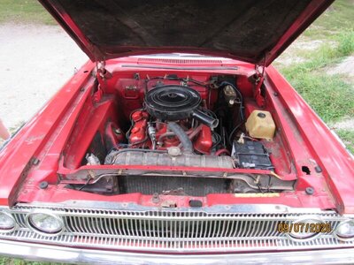

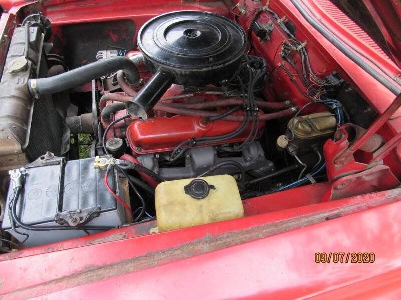

I have a 273 that I used to replace my poly 318. It had a-body manifolds on it so that's what I used. After several years of driving like this I got some small block Dakota exhaust manifolds that dump in the rear. Had to make block off plates for the smog pipes. I like them.
