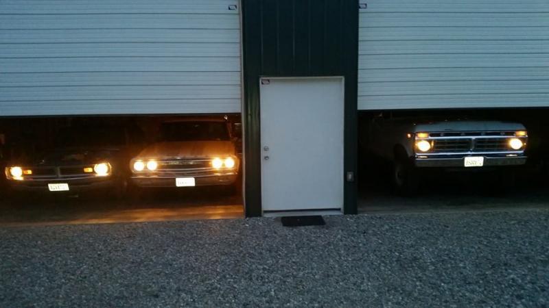

How come when i turn my lights on, i only get high beams which is low beam and high beam a total of 4 lights, but when i hit the low/high beam switch on the floor and go to low beam i get no lights. another intestering thing, if i have the park lights only, the front clearance lights work, but as soon as i turn the lights on (high beams) my front clearance lights go out.

even though the low beam bulbs come on with the brights are on? i thought when low beams are on, only the two inner head lights come on, and then when you hit the dimmer, the two outside head lights come on for high beam, just like my picture about
With the low beams on the outer bulbs should be to the outside, not on the inside!
oh ya, vice versa my bad. should still be a total of 2 low sealed beam bulbs and 2 high sealed beam bulbs
Yes, the low beam bulbs light up when the brights are on, but not the low beam filament. There is both a high beam and a low beam setting on the outer sealed beam bulbs and if the low beam is burned out the high beam will still function.
