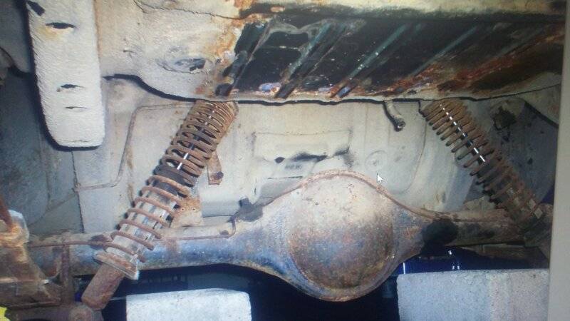

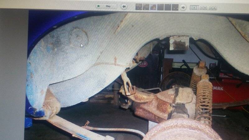

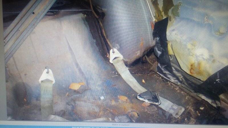

Any good pictures of 65 Belvedere optional rear seat belt location. With the seats out.
Need to install belts for the Grand Kids.
Thanks.
Thunder
TL, here's some Pics of a survivor Belve II, I had about 8 yrs ago. Sorry for the quality, but our internet has been down 3 days now, so I snapped these with my phone, off the screen. Those large washers are backers, underside. Hope these help...
Thanks! Same question I had for my ‘64 Fury. So those are the factory locations?
Nate, not sure about a '64, but the '65 pics above were an un-molested survivor. Look to see if you have those mounts in yours...
