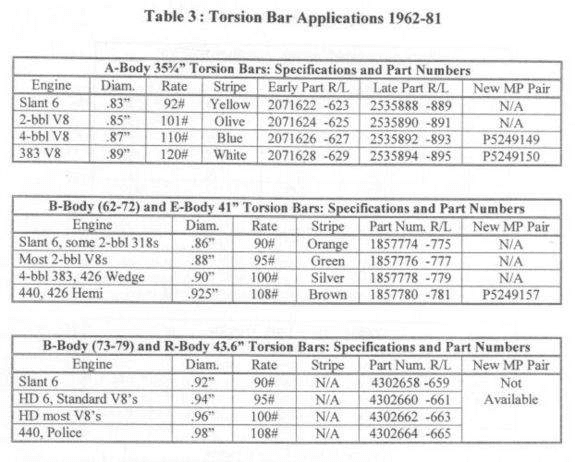

Hey, Guys. I’m going to put a ‘72 440 in my 65 Satellite. It was a 361 car originally. They guy who had it before me put a 318 in it. I read in a thread or 2 about similar swaps. But i’m still a bit confused. Hoping y’all can help. What all do i need to do on the front end? I can get a rebuild kit for the front end with control arms, bushings, etc. I’ll plan for that. I’ll get the motor mount adapter brackets and pads. Do in need to buy new torsion rods and bushings?
Any other things on the front end i need to consider?

You need the right transmission, as the bellhousing pattern is different (and starter location somewhat) beteween big and small blocks. Really you just need a big block main case....you can swap everything into your '65 or pre small block trans if need be. Easier to just find a BB 727 if you have a '66 or later trans. You need heavier torsion bars....but this is only because they all benefit from heavier bars. The reality is, I highly doubt the guy who put a small block in your car went to the trouble to put lighter torsion bars in. The "A" engine is pretty heavy too all told compared to the 361 and the "LA" is not really light either, although less than any big block.

I should have mentioned i have the 727 that came with that ‘72 440. Noted about the torsion bars. Thanks.
What kind of shifter do you currently have in the car? Is it the column shift with the selector cable and park cable? Or did the previous owner put in an aftermarket floor shifter? If that is the case, then the transmission year is kind of moot point, other than possibly the rear mount. You may want to look closely at what you currently have. You will need 63-65 BBM metal mounts and corresponding rubber biscuits. You'll also need a 971 oil pan or max wedge oil pan if you want it to drop in without having to cut on the cross member. Hopefully the previous owner didnt put SBM torsion bars in it and they left the 361 bars. It will be really nose heavy with SBM torsion bars especially turning.
Most agree that even the 440/hemi bars are too light by todays standards.

Afraid it’s the original console shifter. I’ve read i can buy an aftermarket shifter and put it under the original console? Wasn’t aware of the oil pan issue. Good to know. Planning on buying BBM mounts/ biscuits. I’ll check the diameter on the torsion bars.
