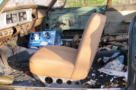

OK, so, I got a set of repro SS aluminum 65B body seat mounts, a set of repro Jeep seats, and two pair of adjustable seat tracks.
This picture shows the seat without the adjustable tracks (yes, car is filthy!)
My question is this, I am 6 feet tall, not a giant or anything. But with a helmet on, I am just barely grazing the headliner (no seat tracks). If I put the adjustable seat tracks in, I lose about an inch of clearance.
Has anyone else had this problem? It would be nice to be able to adjust the seats but it isn't really necessary. I don't recall who made the aluminum mounts but they look right to me (not that this means anything).
Van seats had adjusters that were only about 1/2 inch tall
What you need is the SS brackets for an A-body! They are an inch shorter in height! I have some adjustable tracks If you're interested! P.M. me
plus your seats are probably thicker that the original a100 van seats they used.
I just checked my notes. The seat adjusters add 1.26 inches. Without adjusters, I have about 3/4 inch clearance when wearing a helmet. The seats are made by Bestop (for CJ5 jeeps). I am pretty sure they are thicker than original SS seats. Would the Dart SS seat mounts work in the Belvedere?

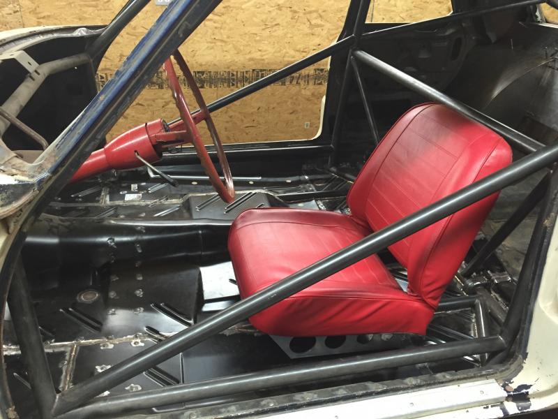

Badvert, I've noticed the same thing with my 65. I have the B-body brackets and A100 van seats. I am 6ft and bit and my head touches the headliner with this set-up.
(That's not me in the picture! Its the next owner checking things out).
