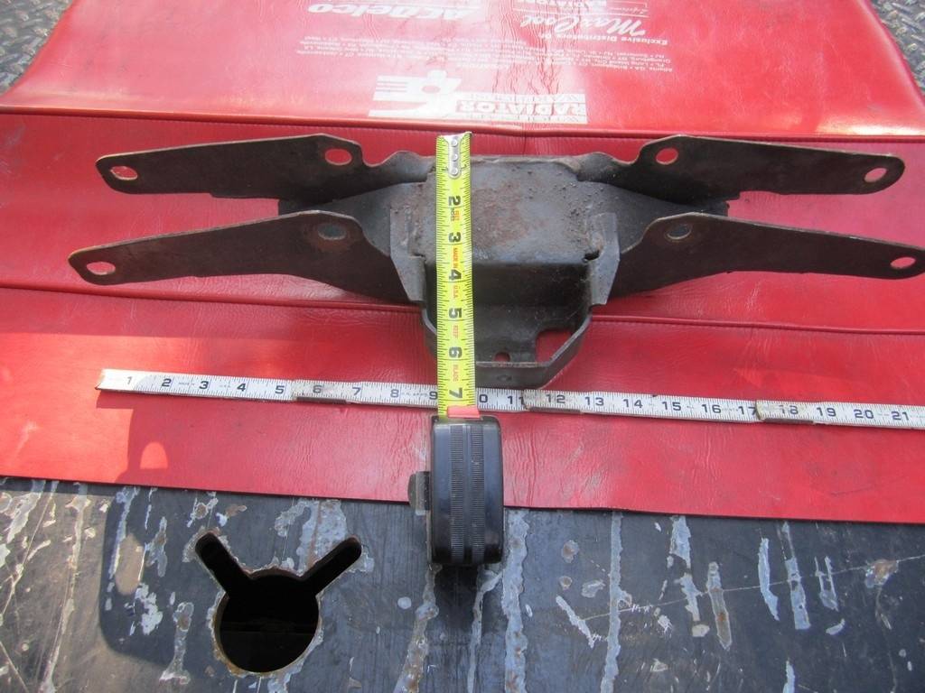

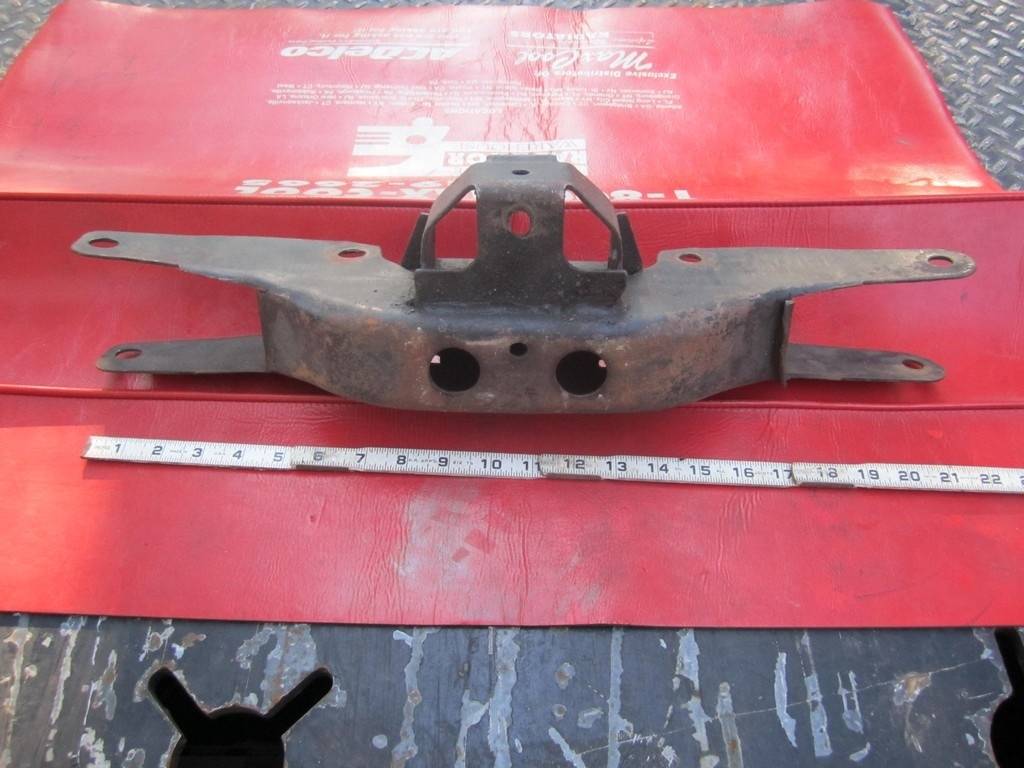

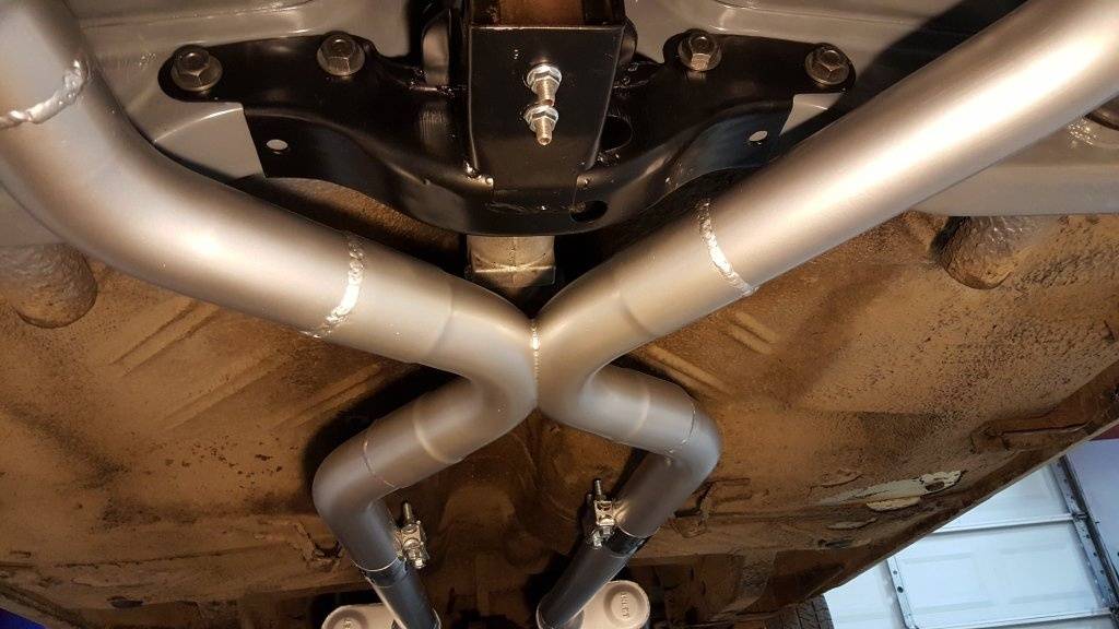

Are you talking about the "black" piece in this picture?
I have one off of a 66 belevdere if they are the same pm me
It's just called a crossmember.

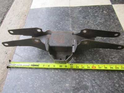

Hang in there, someone should have one on here. Here's one on Ebay, Seller is from your state too! Make him an offer...

The 1966 and later transmission crossmember will not work on your 65. The bolt spacing is different. The 62-65 B-body has outer bolts spaced 14 3/4" and inner bolts spaced 8 1/2" The 66-69 B-body has outer bolts spaced 20 1/4", inner bolts spaced 8 1/2". This info came from Brewer's web site. http://www.brewersperformance.com/products.asp?cat=26
I just checked out the 62-65 crossmember on ebay. That's a good deal... You need to grab it.
