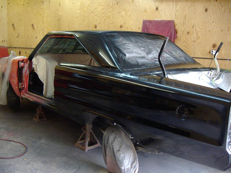

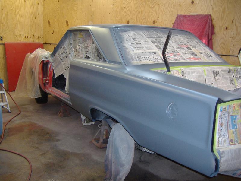

I bought both sides for $300 delivered to my door when they first appeared. I didn't think they were that bad. It's a lot of work either way, these quarters are long! car 03.jpgcar 01.jpgcar 18.jpgcar 19.jpg
I didn't actually put a micrometer it, but the long panel I ordered (via JC Whitney) in 2010, felt half as thick as the original metal. It also had one corner rolled (damaged) when I got it. I promptly sent it back and got the Sherman panels. Just as thick & sturdy as the original metal. Maybe quality control has increased on the long panels? Your finished product looks very nice, moparbud66.
Thanks guys, I have some color coats on it but will need to block it out another time or two to make it super straight.

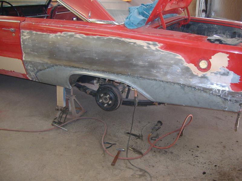

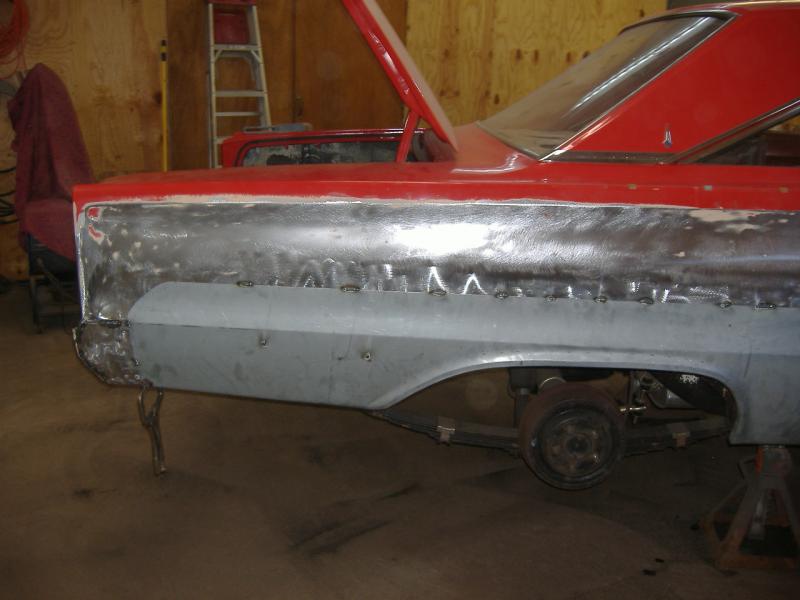

I bought both sides for $300 delivered to my door when they first appeared. I didn't think they were that bad. It's a lot of work either way, these quarters are long!View attachment 232603View attachment 232604View attachment 232605View attachment 232606
Just out of curiosity, did you lap those quarters or did you butt weld them? They turned out very very nice. I am looking at a rough 66 Belvedere, needs all new panels but I can have it for free, I was thinking of a full tube chassis car. But it needs the lower quarters. This is the aggravating thing about the 66-67 B-body's. They all need quarters but nobody pop's them.

Chad, I lapped them over after cutting out the bad areas. There are some welds from the inside as well. I was into this car deeper than I wanted to be and using these panels kept me from going even deeper. It will look fine in the end and for the use it will get in the future, this repair was adequate for me.
