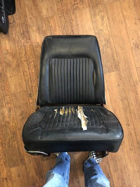

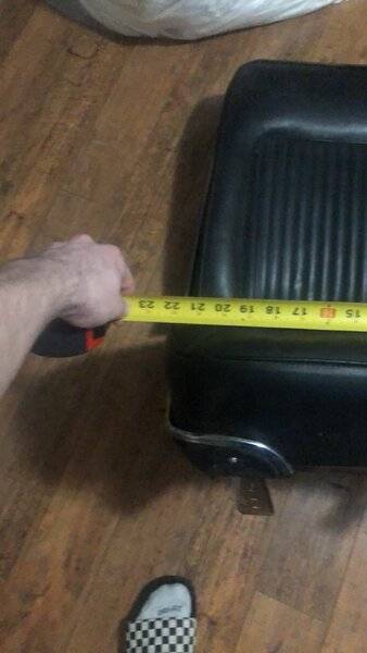

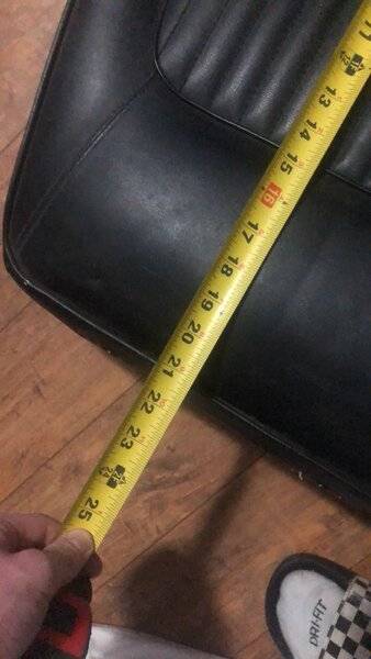

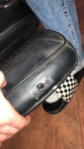

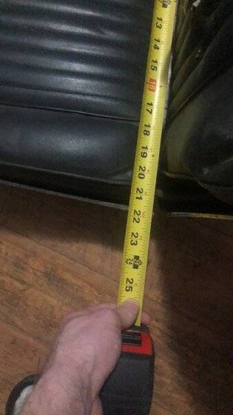

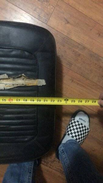

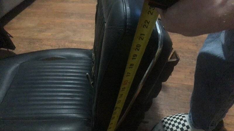

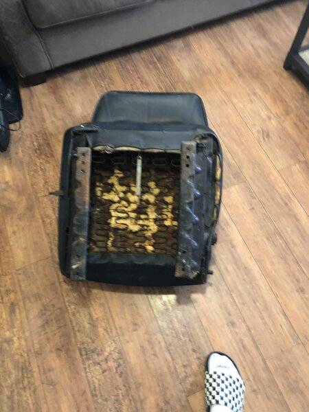

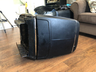

I bought these seats a while ago he said they were b body but skins look like barracuda but they didn’t fit his 65 would like some help figuring it out

67 Barracuda buckets. The tracks and seat backs are different from B bodies. Where did the headrests go? They were optional.
Maybe they have b body tracks on them now. On B Body the spacing for the floor holes are 11” front to back, and 14” sode to side.
The tracks probably didn't fit a 65 A body. What have you tried them in?

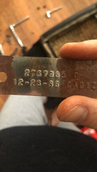

Any chance of you guys having the seat tag to see if it matches with a b body
