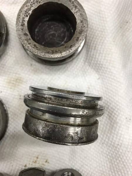

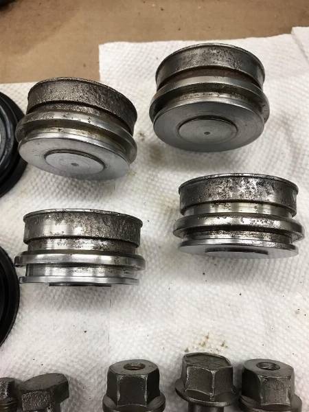

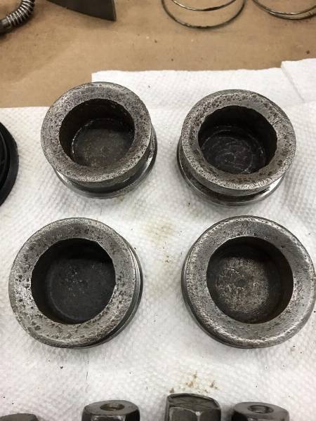

Finally got my reseal kits for my brake calipers on my Coronet. Got the calipers off the car and pulled apart and have been cleaning them and noticed that the pistons have some pitting and corrosion where the seals will sit and I feel that this will allow some seepage to happen past the seals.
Pics of pistons...Fresh out of the electrolysis rust removal bath....

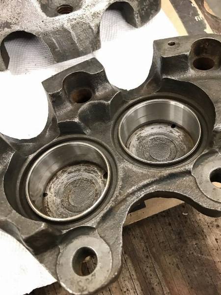

And the caliper bores are in great shape since I had them sleeved in stainless 25 years ago!

You need new pistons (I know, un-obtanium). The pitting is very bad in the seal groove. Does the vendor that sleeved them for you previously have SS pistons available?
Your pistons are junk, RTV, you are joking right?

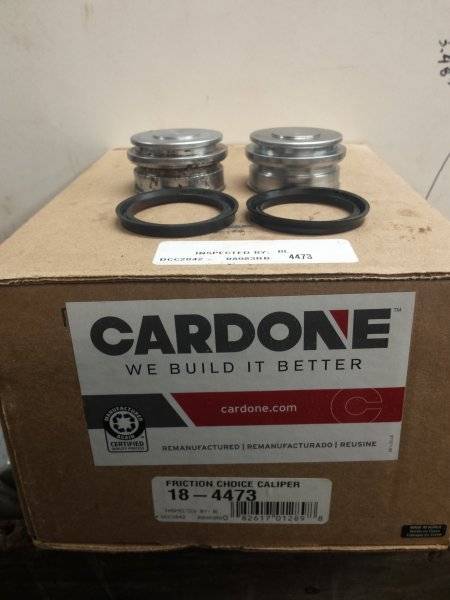

Might be cheaper to order those, pull the pistons out to use in my sleeved calipers and re-assemble.

The Cardone calipers are Chinese... Not reman, no core... I've installed a set and a single... They work if your Okay with Chinese calipers.. The same part work R or L by using the bleeder screw & the hose inlet in the opposing port..

I've ordered a set of the Cardone calipers....gonna just use the pistons and seals in my OEM sleeved units. I've been looking for pistons but can't seems to find any...do you have a source?

I'm not confident the Cardone pistons are gonna fit your OE calipers.... I'll look for pistons & post back shortly...

are the bores in the Cardone units even the same size as original Calipers?
you will Find out

Was thinking about this last night while working and I think I'll just run these new caliper and in the mean time I'll hunt for a local machinist who can make me a set of new pistons to fit my OEM calipers. I had not thought about the pistons being a different size...Well I will measure them and see I guess, good info to have out there for others going through a similar scenario trying to restore their cars.

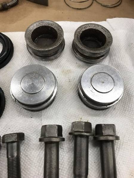

I was going to machine pistons out of stainless steel to prevent future pitting..but bought new calipers instead. Here's a picture of the Pistons and the oem piston measures 1.999" O.D. and the new one measures 2.000" O.D. oem one is one thousand of a inch smaller probably due to ware.
There should not be any wear on a brake piston, they just don't move that much (distance-wise) I suspect the .001 is just allowable tolerance.
