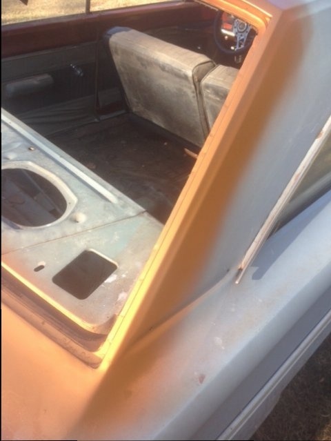

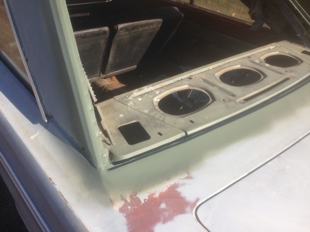

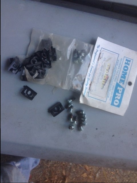

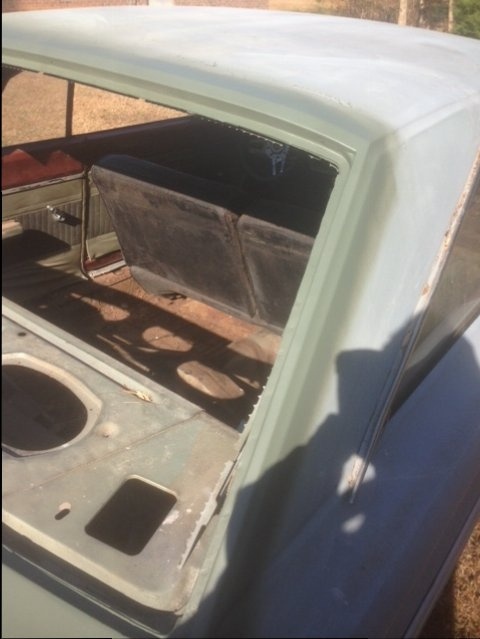

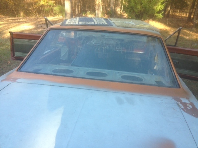

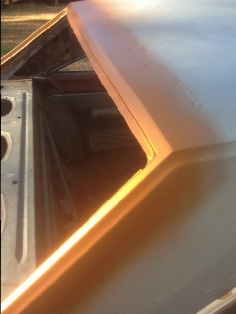

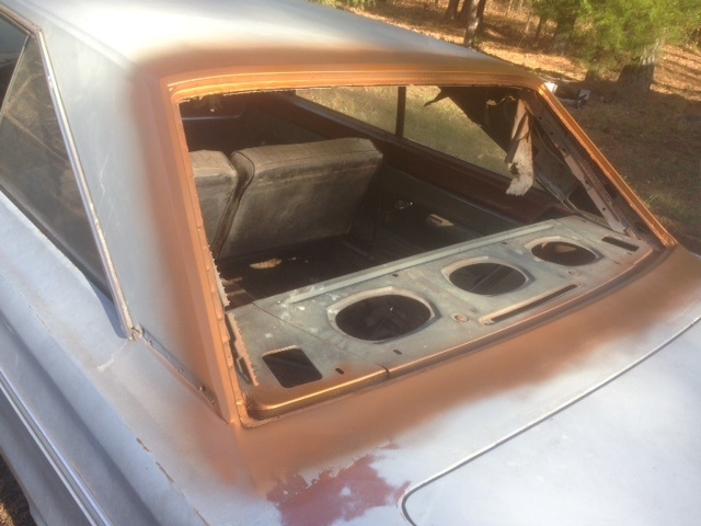

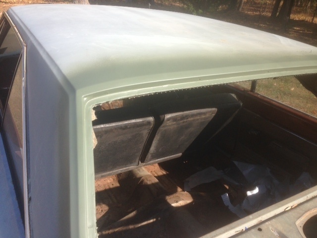

I finally got time to work on the Belvedere today. I sanded the glass channel & looked it over good. I then primed it with Dupli Color rattle can Epoxy Primer 3 coats. Allowed 1 1/2 hour to dry then I top coated the Chanel with the Dupli Color pre mix paint. 3 coats also. Allowed 1 hour to dry then installed new molding clips. Looks good. Now to install the glass.

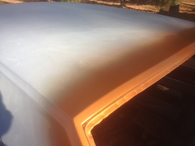

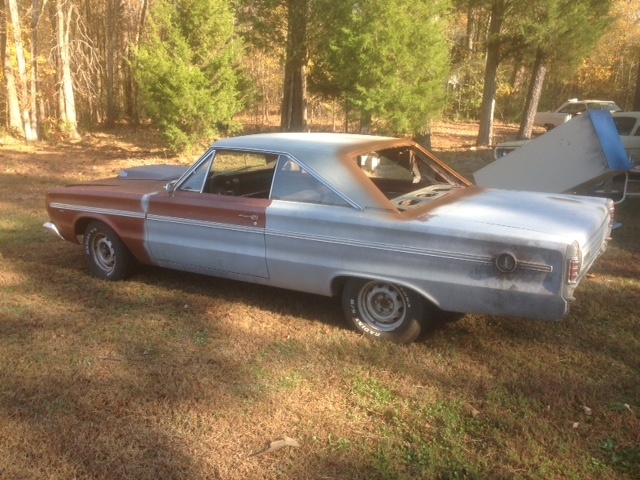

The 3 coats of paint. I'm on a budget & wanted to use this Pre Mix Dupli Color paint. No thinning or reducing required. I wanted a color similar, but lighter than the original Burnt Oranged. Also with a fair amount of metallic. This paint has the proper amount of metallic I was looking for, but is a bit too light & too gold to blend in with the painted interior & door jams. So I'll have to do a darn color change. The paint laid down good
Here is a pic from a distance & you can see the difference in the color

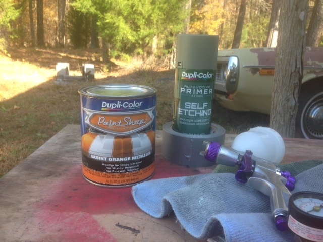

This is what I used. If your on a budget like me this looks like the way to go. $5.00 for sand paper. Started with 280 then 500 & finished with 2000. 1 can of the Dupli Color Epoxy primer $6.00 and 1quart of the Dupli Color pre mixed paint $24.00 I had a gift card from Harbor Freight tools for $50 so I went to their store in town & bought a paint gun kit. It came with two gravity feed guns & cleaning tools. So I have less than $100 bucks in this & still have plenty of paint left.

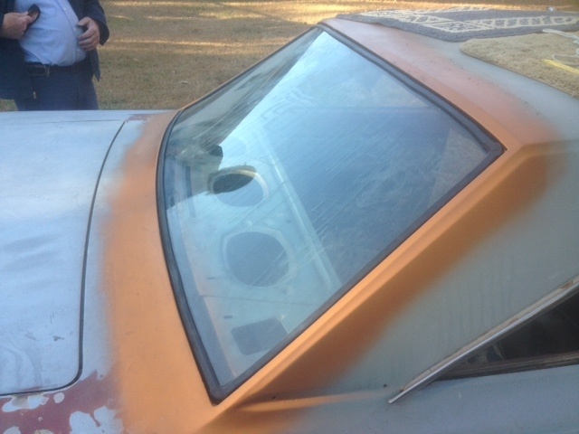

The rear glass is in. Took two tries. First time i had the rope snag in the corner. I tried to pull it past the snag & it broke the rope. Sooo took the glass back out since I had only gone about 2 feet. Installed new rope & tried again. Samething , but this time I knew what was snagging it & just easily worked the rope around the snag. Second try was a success. Next will be a bad power steering hose leak. Looks like the return hose. It's making a mess so need to get to that. Stay tuned
