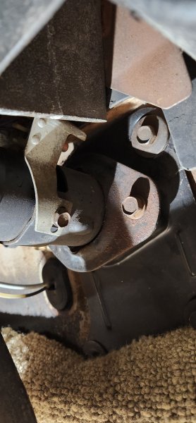

So after posting up my wtb ad, I realized I was mistaken and needed to refresh my antique memory with what all my car had and didn't have. What I really could use is pictures of under the dash, specifically the reverse light switch wiring. Also, I need to know if a 66 neutral safety switch will work in a later model trans with the 3 prong switch. I am attaching pictures of what I have. I figured out that I just grounded my nss wire to the firewall, and I would like to put the correct NSS into this trans so I can hook up my NSS wire properly.

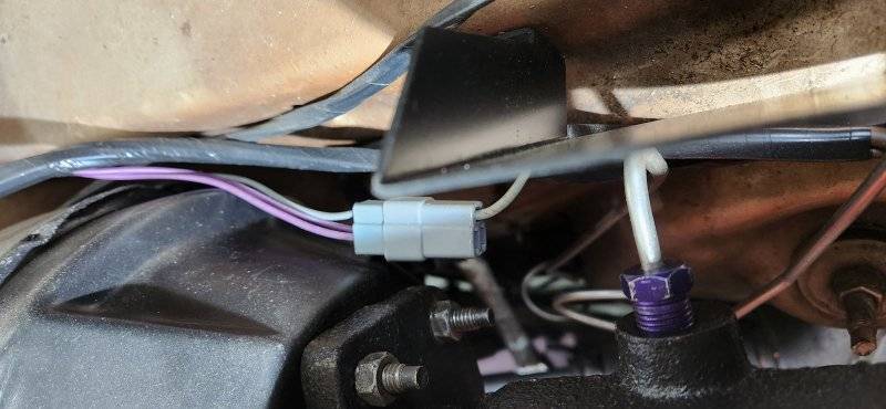

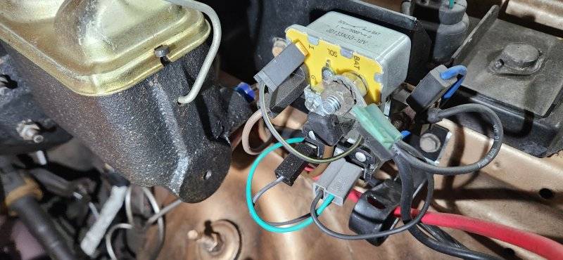

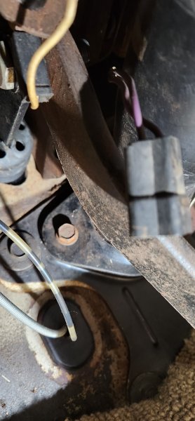

So the reverse wiring is what I don't have and need info on. Here is what I have. I need to know where the unpinned gray wire I'm holding goes to. Any help would be greatly appreciated
center pin on the 3 pin is ground in park and neutral.

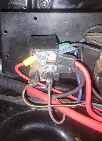

simply attach relay terminal ( lower right spade , brown wire on your relay ) for relay proper operation
Switch on your column shift car is backup lights
Should be able to hook those 2 with the outer pins on the nss and eliminate the column switch.. not stock but better

" I think" the rooster comb ( aka manual lever ) in the trans is different.
You have a correct 66 trans pull its pan and compare ????
edit, the trans in MY car is a 1970 model. and it has the correct 66 NSS.
But I do not know " IF " the manual lever has been changed , or not.
Ok, so maybe the nss only hits the neutral and park part of the rooster tail, I seem to remember from my fog of a b tree ain that the nss and reverse combo switch had an extra part in it that extended or was tripped in a different fashion than the neutral sense was. Worse case is I try it and it doesn't work.

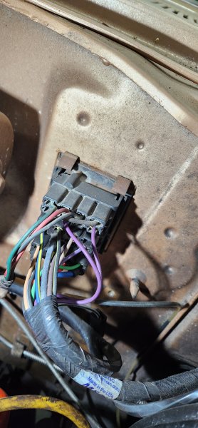

Still need pics of the reverse wiring for a column shift.
Dredging the memory bank, think the “rooster comb”(?) doesn’t have the plastic thing on it for early NSS switch only. Plastic is on for the 3-prong switch.
Not certain, but gray wire almost looks like it goes to oil sending unit on back of engine.
I found the harness. A guy from here and fb sold it to me. I am going to remove the wires from the harness and then hook it up to see if everything else works, switch is good, etc. Thanks for the responses. Next will be trying out a 66 neutral safety switch for grins and giggles to see if it functions in a newer trans.
