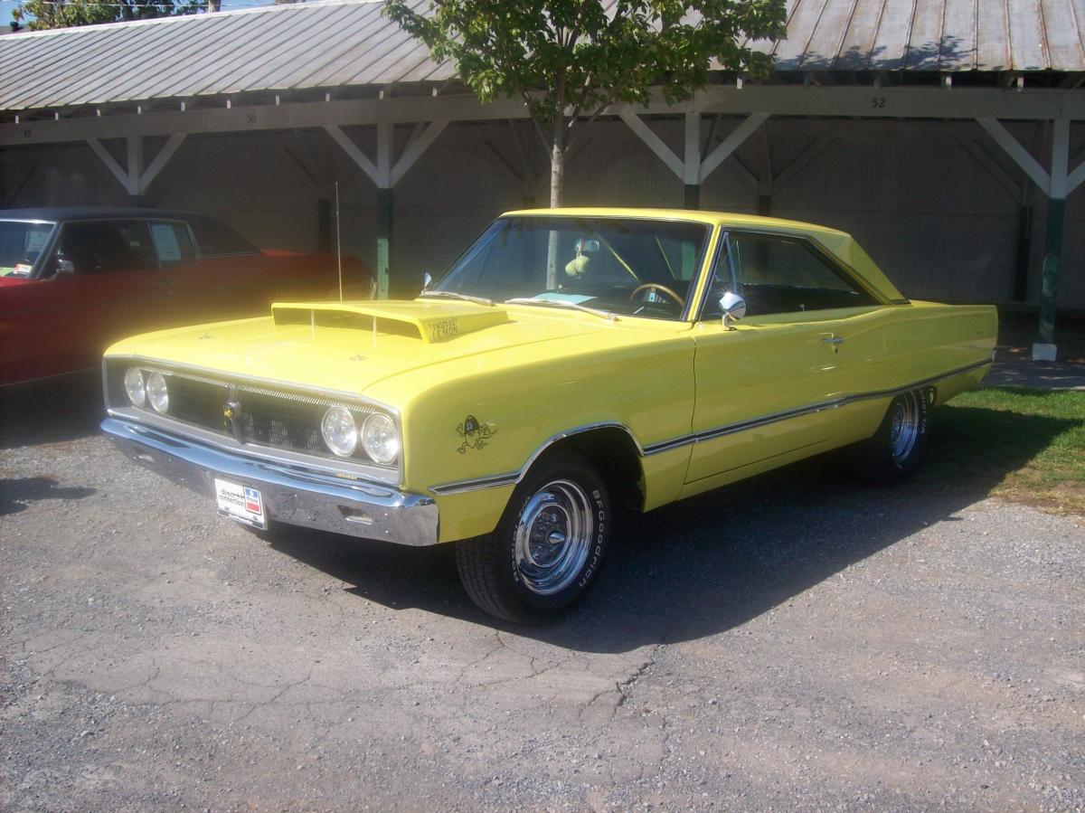

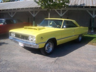

If I was you I would keep it simple. These cars ride like a dream and are great to ride in. We have a 67 that we built for my son and its a little wild for him. He drives with hand controls and has a little trouble. After watching him I think you don't need much to enjoy you car. Besides gass is a problem anyway. Good luck and remember "Its not a car unless its got a star!" Hemihenry

I have a buddy in KC that runs a 80 Zephyr wagon with a turbo 351 and an Accel FI setup. The car is nothing short of amazing. He get's probably 18-20 MPG on the highway (driving like a sane person) can bring home a load of groceries and run mid 10's at the track. Just this last weekend he tried some E85 with boost and fuel curve to match and went 10.06. Just frickin' amazing. He knows my car and says if I put a mild turbo on it I can run 10's in my 440 powered 3700 lb car and not break a sweat.

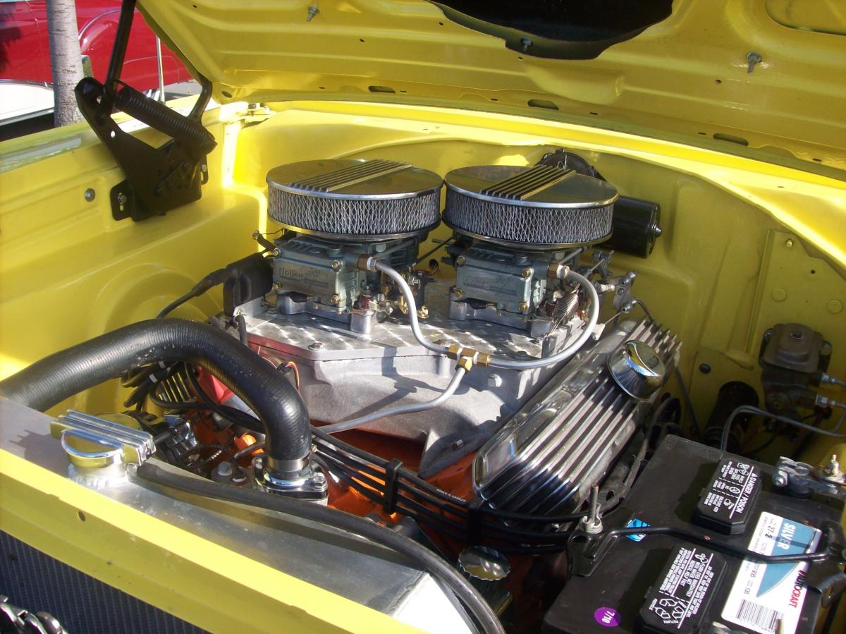

If you want to build a CHEAP effective normally aspirated car that will probably run 80 K miles with only regular maintenance and give you some nice results look no further than my 66 Bel. My data is posted in the "12 second combo" thread.
Love the STR setup!! If you know where I can find an inline dual quad top let me know. I have a buddy looking for one.
