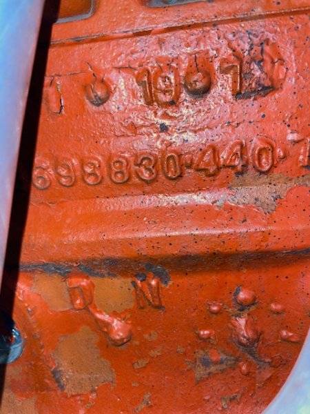

I know there are a bunch of threads on decoding engine numbers, but i cant find one that helps me here
Looking to figure out what year this 440 is (i think a crate 440?) since it is not original to my Coronet
my '66 Coronet originally had a 383 in it, but someone pulled it and put a 440 from i dont know what
from the pictures attached, i gathered the below, but im not sure what it means - was my 440 built in 1973?
looking to make sure i get the correct oil filter, spark plugs, wires, etc for the car.
7 – 19 – 73
3698830-440-7
D N
any help is appreciated, thanks!

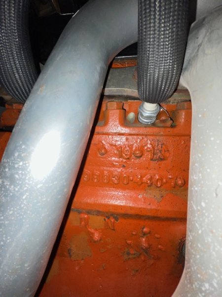

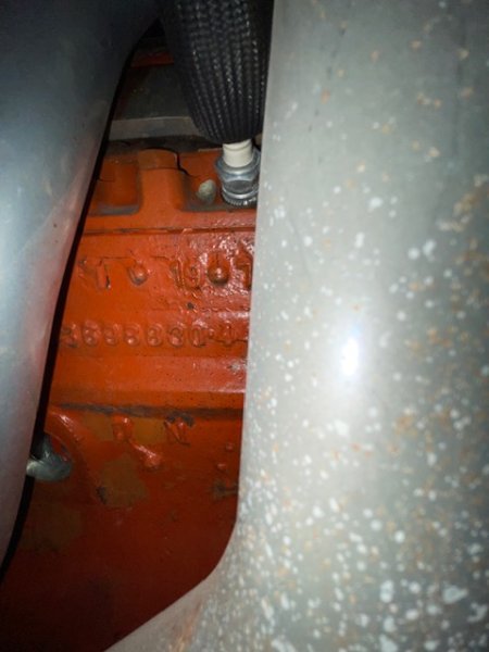

D arrow pointing to it indicates Day shift casting
3698830 – 1972-1978, 440 RB-series big-block
7 – 19 – 73 Seventh month 19th day of 1973. The numbers you want to post are found on the flat pad up by the water neck.

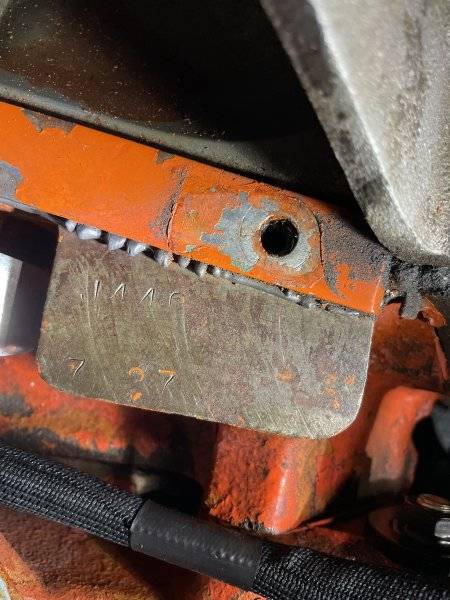

Got it, I knew I was missing something. All it says is :
J 440
7 27
Believe J is for 1974 and 440
Built on 7th month and 27th day? Pretty sure that is correct.
So block casted on the 19th and built on the 27th of the same month. Pretty cool
The "J" is 1973. ("I" was skipped from usage)
Build date July 27th.
There may be additional info stamped on the driver's side pan-rail outcropping below the starter. Gotta crawl under for that....
J 440
7 27
"J" =1973 model year
440 = 440 ci (Non HP)
7 27 = Assembly date = 27 July 1973

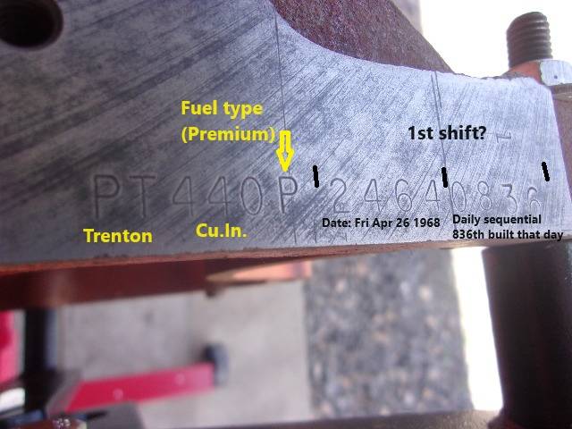

10,000 day calendrer began 26 Jul 1961 = "S"
63 = T
64 = V
65 = A
66 = B
67 = C
68 = D
69 = E
70 = F
71 = G
72 = H
73 = J
beginning in '74 = "4T"
75 = 5T
