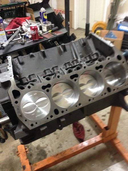

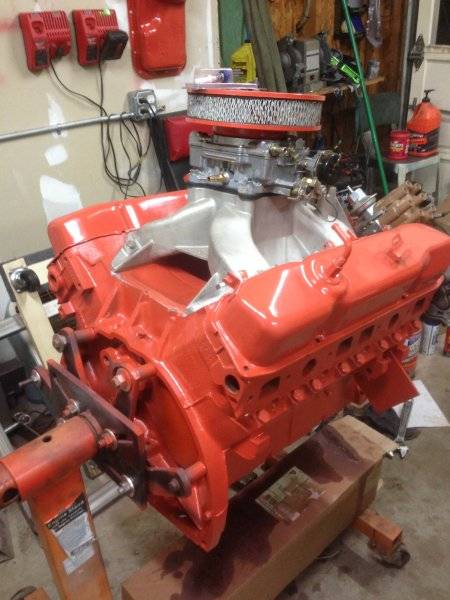

Just because the numbers make it out to be a low compression 73 440 does not mean that is what it is. This is my 75 block 440 but looks can deceive you. It also has 1969 valve covers, 1969 HP manifolds as well as a Mopar M1 intake. But the goodies are on the inside. And what was done to the block. Also what was done to the heads. Its not a low compression engine any more. This engine is 9:64 to 1 compression when I was done with it. Could have raised the compression more with different head gaskets. But wanted to keep it gas pump gas. Engine guy told me around 500 HP with 600ish foot pounds of torque.

View attachment 1542340View attachment 1542342
She’s a beaut!
