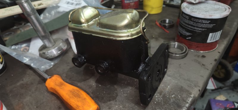

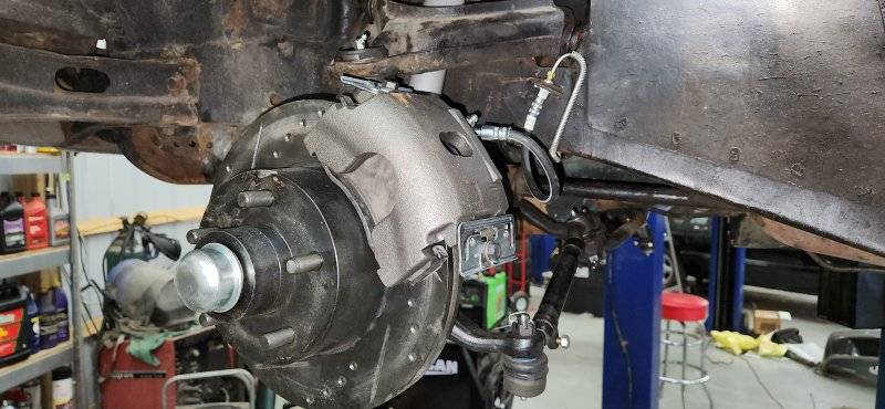

It's looking good!Today I made big progress, finally. I replaced the wheel cylinders, tightened all the fittings in the rear and got the drums back on. Did I mention it was 100* with 70% humidity? I moved up front and installed the grease seal using my bearing race and it worked great. I got the rotor on and had to grind about .080" off the bottom lip of the dust cap and it went on flush. The new ones they sell won't go flush unless you grind it off some. I got that on and moved to putting pads and calipers on. Here's where I dropped face first into the suck.
The rotors are thicker than stock and the pads are thicker than stock, typical if the current chinesium rotors and pads. I used 80 grit and then 60 grit airfile paper to lay on a 2x4 and slid the pads back and forth until finally, the skies parted, the angels sang and the darn thing went on. I looked up the 73/4 repair manual and figired out what the Orings in the hardware kit go to, and how the retainers and anti rattle clips went on. The rotor spun and everything looked good. Having learned my lesson, I grabbed my calipers and measured the pad thickness and then went on sanding until I took .020" off each pad. It slid right on. Thank God something went my way today. There were a lot more things that just planted me face first, but I'll spare you the details. Suffice it to say that I did 2 hours worth of work in 6 hours. One thing after another. It sucked.

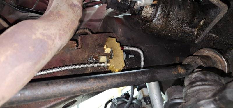

Got both front rotors and calipers on, hoses into the brackets, and retainer clips installed. I grabbed the metering block(after searching for it fo 30 minutes, it was in the trunk with the rest of the lines), and figured out which holes it went into and what orientation it needed to fit. Sat down with the lines and figured it out. Mounted it to the frame rail and got the driver's caliper line attached to the metering block tightened into the hose. Got the line to the rear tightened into the metering block too. Can't wait to get this finished. Going to use Dot5 in the system. It's really taking shape now. I can see light at the end of the tunnel and I don't think it's a train, this time.

I just put the same calipers on a Dart and I fought with the pads a lot longer than I should have had to. Luckily I didn't have to remove material from the pads, but I did have to make sure the pistons were pressed all the way back in the caliper!
