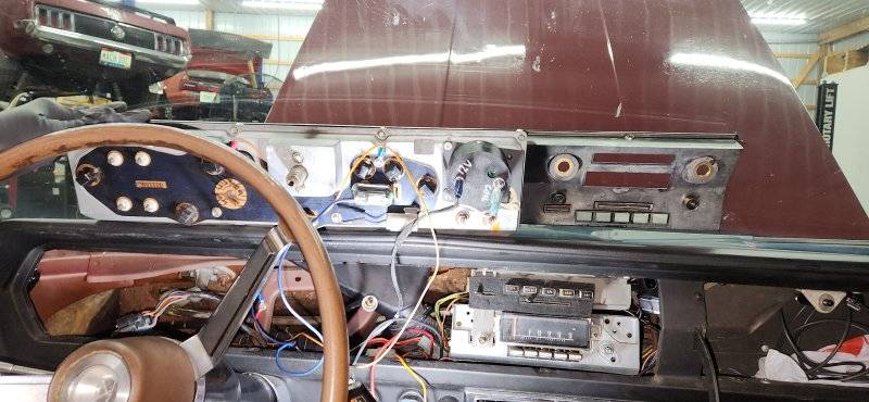

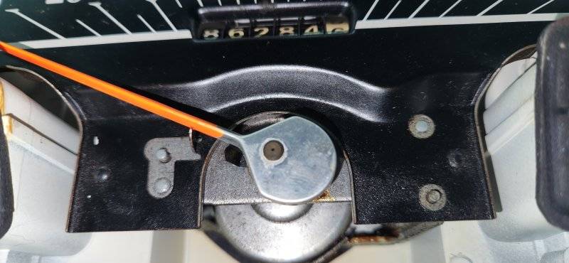

Monday night, I decided I had to know if I was right about the speedometer being stuck feom painting the needle. It was a pita but I got it apart and sure as crap, it was stuck on the needle stop. I flicked it, it went PING, and released. The paint had sried to the stop. Now I have a working speedo. Yay!

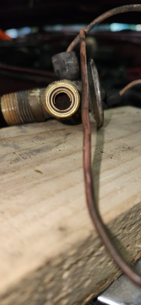

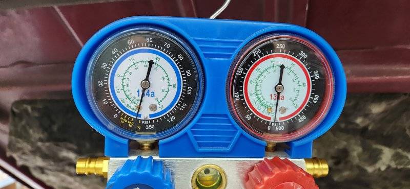

After discussing this with WildRT, I decided to kill some baby seals and let all the 134 out of my system. I hooked up the gauges and turned the knob on the high pressure side, but when I opened the valve on the low pressure, the pressure jumped up a bunch. That confirmed my txv was stuck closed or blocked. Turns out when I poured oil in the hose, it drug a bunch of trash to the txv with it. You can barely make out the issue, fine, black goo.
New TXV should be sitting at O'Reilly's. This means the ac system will work soon. Yay! The entire system is getting an overhaul when the engine comes out
I stopped by O'Reilly's yesterday on my way home and picked up the new txv. I waited for the shop to cool down and installed it with the provided orings.
But first, let's back up a bit. Getting that txv loose from the evaporator inlet was an absolute bia$$ch. I was convinced I cracked the inlet tube at the evaporator. The old one did not have a hex made onto it at either threaded fitting end, so no way to grip the txv while breaking the fitting loose. I finally used a blick of wood to stabalize the assembly, clamed vice grips on it, and positioned the wrech so I could squeeze both of the simultaneously and it broke loose! Tgis after about 3 hours of cussing, frustration, yet no wrench throwing, I am improving.
I pulled a vacuum on it and it instantly went down as far as the gauge goes. I let it sit for 30 min and it went up 3" vac. I turned on the vacuum pump amd pulled on it for 15 min and then closed the valves and turned off the pump. I went inside for the night.
I came out this morning and the gauge still read 28 or 29"!!! I call that fixed. I charged it with 3 cans, pressures were 30 to 40 low side and 175 to 250 on high side, 99 deg shop temps. Ive cold air blowing out the vents.

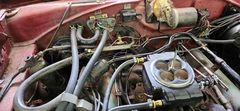

I hooked up my laptop and worked on idle tuning and got that dialed in to where I am happy with it, and took it for a ride. Ran and cooled great.
New issues, need to put my ccs or css, whatever, into my coronet and put my og radiator into the belvedere. I think that will solve my 200 deg running temps. Not hateful but cooler is better on this old thing.
Worked on cold start up this morning. Tired of rough starts. Hard to tell which is affecting it more, running on 5 good cylinders and 3 weak ones, or the tune. Lol. Going to hook up the wot ac cut out output and ac on input after I get these heads ported I'm working on.
I have EFI planned in the future, multi port, but not going to waste my time right now since it has an appetite for oil.
