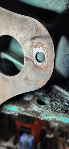

With the help of my buddy Neil, i put the coronet on the 4 post rack and ran it up with him in the car. I had him start it and used my stethoscope to isolate and locate the noise. Turns out it was in the bellhousing! Just shows you how noises propagate through the driveline, since I thought it was in the timing cover. Pulled the inspection plate off to take a look because I had a good idea of what it was. Got an 1 1/4 socket on the crank bolt and rotated the engine looking at the torque converter bolts. Here is what I found.

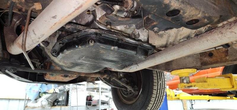

I also found the trans pan is leaking and the gasket needs replaced. I am planning on getting a new sfi flexplate for it and just doing gasket, filter and fresh fluid while I'm at it since the trans has to come out to replace the flexplate anyway. If the noise wasn't so annoying, I wouldn't worry about it, but it's like fingernails on a chalkboard to me. Glad I figured it out.

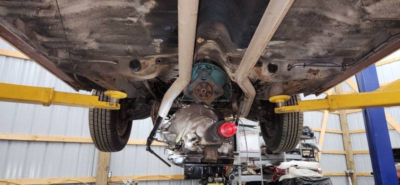

I got the car in a lift and got it up in the air. Someone had put a drain plug in the pan so I drained the fluid out. I dropped the pan and the filter too. The pan had lots of wear debris but not bad for such an old car. The bands were way out of adjustment. I kind of assumed that by the delayed reverse engagement it had. I searched for a video and found one on how to do it and got them adjusted, both front and rear. I cleaned the pan and the trans surfaces and wiped it all down until it was clean. I got it tightened up after letting it sit for about an hour just finger snug. I drained the oil and removed the filter, too. I had not changed the oil since I got it almost 3 years ago. I used valvoline hot rod oil that has lots of zinc additive. I pulled the driveshaft and then lowered the car down. I disconnected the battery and then poured in 5 quarts of oil. I raised it back up and tightened all the trans pan bolts. Figured it was time to call it a night

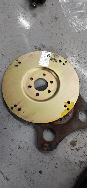

Just realized I didn't finish this. I got the flexplate out and it was badly cracked. I could flex it and it would make that clicking noise I heard with it running. I replaced the pan gasket and filter before I pulled the trans. It came out relatively easily. I got the driveshaft out and slid the trans back far enough so I could get to the flexplate.
Got it all back together and let it down to put fluid in. I put 4 in and figured that was good enough to start with. Man, these thjngs are thirsty! I think I ended up with 7 qts in it. Couldn't believe it. So got it up to the hash marks almost to full, as it wasn't hot yet. It went into gear, forward and reverse. Backed it out iff the rack and pulled it back into the shop so I could do a couple other little things to it.

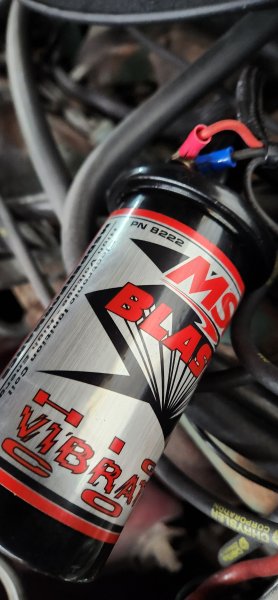

I swapped out the coil with this one from MSD, it isn't filled with oil, it's filled with epoxy and can be installed in any position. I opted for it because I needed a new 12V coil anyway for my electronic ignition since it runs without a ballast.

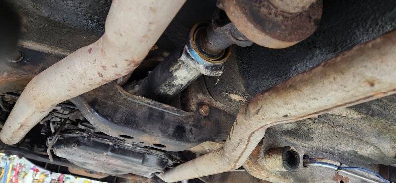

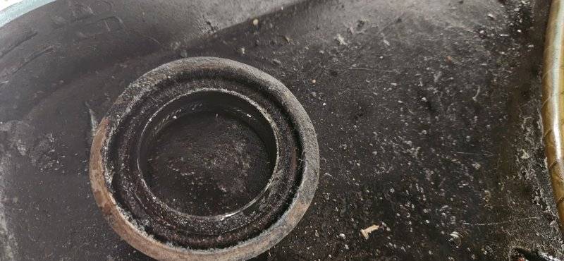

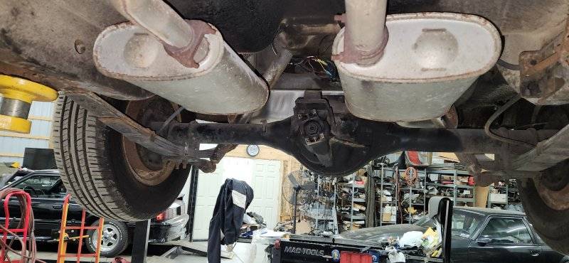

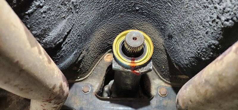

So I thought all was well, until I walked in the shop and walked by the car to see a small stream of fluid coming from under the car. Sweet! I figured it was the pan gasket or the dipstick tube. So back on the lift after playing car tetris to get it there. I got it up in the air and to my surprise, the darn output shift seal is pouring out. Sweet!. So I figure I'll pull the tailshaft housing and replace seal and bushing while I'm at it, right? Well, nope, turns out the entire trans has to come apart to get the tailshaft housing off. So plan B, I am just replacing the rear seal. Hopefully that will fix the leak so I can drive it.
Put the new seal in. Wasn't a hard job at all on the rack. Old seal was hard and cracking. New seal in. Test drove it a bunch and no leaks!! At least so far. I want to drive it to Columbus and back just to see if it leaks any. Currently, it's dry everywhere under the car save the power steering box.

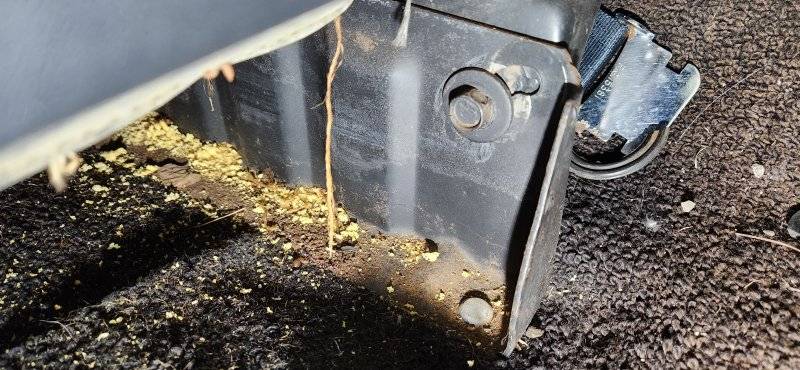

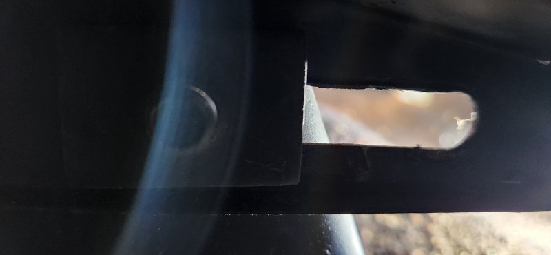

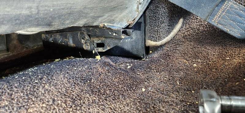

Today, I took the car out for a drive, and just decided to look under the seat and see if there was any way to move the seat back, so I wasn't sitting on the wheel. It was really uncomfortable, as I'm a tall, big guy. I looked and low and behold, the base has 4 adjuster bolts and slots. After closer inspection, I found they were adustable front to rear(they were all the way forward) and also up and down(they were all the way up). I grabbed my ratchet and 9/16" socket and 15 minutes later, my seat was low and about 3 or 4" further back. It is so much more comfortable now. My driving position is fantastic. Can't wait to take it on a long drive now.
Here are some pics for posterity.

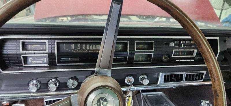

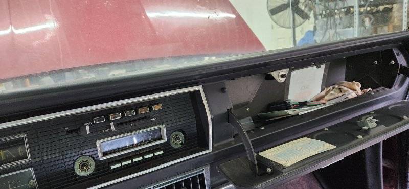

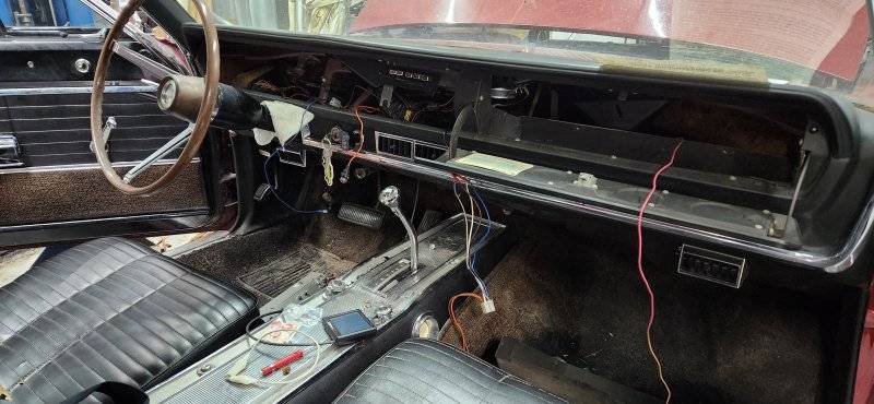

So my gauges didn't work, my radio had no sound, turn signal indicators worked when they felt like it, dash lights barely lit up the gauges that didn't work, although the speedo did, just couldn't see it.

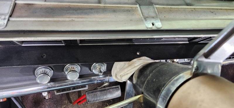

I read around and never really found many pics of a coronet cluster removal but I did find some step by steps. Once I started I just figured it out as I went. Before I knew it, it was 10 pm and it looked like a bomb went off under my dash. Lol. Hood day, reminds me how old I am though, but it's good for me.

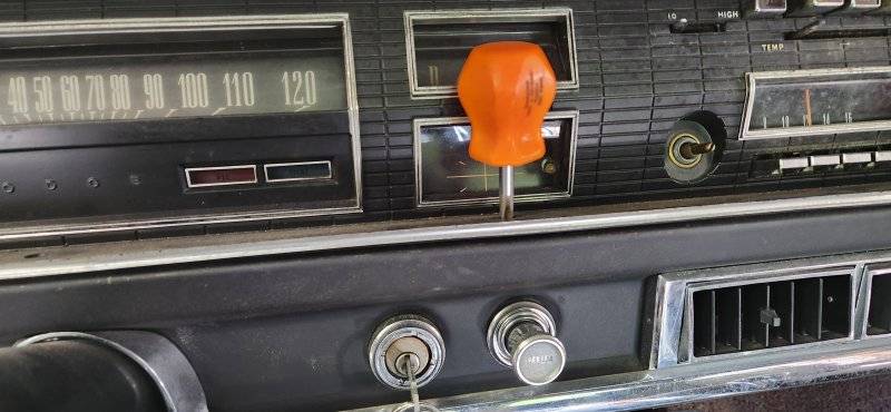

First thing was to take the radio knobes off and the 2 hvac knobs off with a 3/32" allen wrench. Set screw is underneath them. The radio nuts are 5/8".
It's not necessary to take the glove box liner out, unless you want to remove the speaker, but we'll get to that. I just opened the door for extra clearance.
Next step is to remove the screws that hold the cluster to the steel dash.

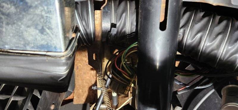

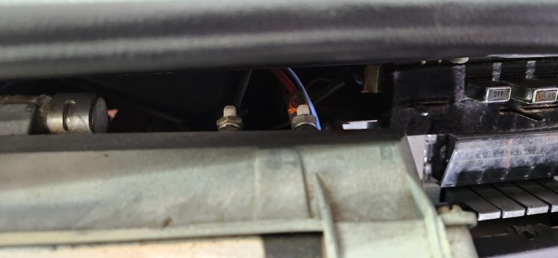

Next is to get under the dash, work your hand an arm up around the brake pedal up into the dash and get a grip on the speedo cable and remove it from the speedo. But first, all this crap has to get out of the way if you have AC.

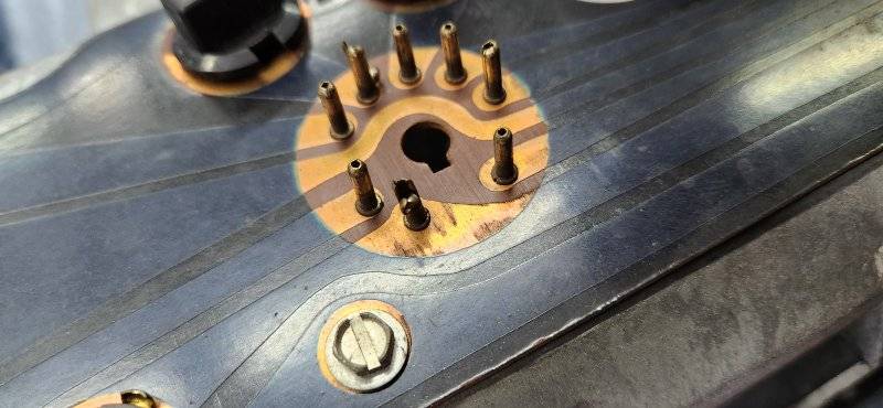

Also unplug the round connector from the cluster printed circuit board.
After getting the speedo cable unscrewed from the speedometer, and unplugging the round connector, once all the screws are removed, it can be tipped forward and the nuts holding the wires to the amp gauge removed. I also unplugged tge external ground wire someone else must have put in chasing the same issue I had with the gauges.
I put a rag on the column to keep it from getting scratched or scratching the bezel. Once I got it out, I flipped it over and checked out the back side. I found a couple pins were slightly damaged, so I messed with those and got them better.
