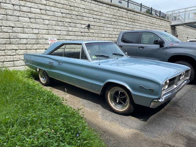

66 Coronet 500 Driver, Light Resto
I got the manifold on and tight, put the new plugs back in and connected the new plug wires. I tightened all the remaining hardware on the intake and brackets and put the exhaust pipe flange up to the manifold. I had to prime the carb but it fired up and for the first time since I got it, it was whisper quiet. It sounded great. I'm excited. New brake shoes should be in tomorrow morning, those go on and then the freshly turned drums with new bearings and seals as well, then more fuel and I hope a successful test drive!
Tonight I drove it for about a mile!! Doesn't sound like much but it took me 3 months to achieve this. Man it rides smooth. Engine is running a little rough, but smooths out going down the road. I'll work on that once the fuel injection is installed. I think it's a carb issue, but I'm going to pull plugs in a week or so after I put some miles on it to see what's going on. AFB needs rebuilt badly but since the Sniper is on order, I don't want to invest in having it rebuilt. Second drive is happening tomorrow, longer and probably use the ac.

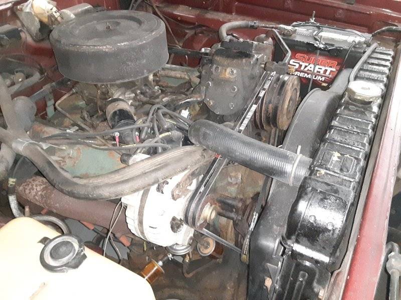

It just threw the ac belts today and ruined the PS belt as well. Luckily the water pump belt was still hanging on and I was able to put it back on. Car got hot but this engine is pretty fucked already so it's no big deal. It'll get rebuilt soon. I want to work all the bugs out before I go thru it.
So late last night I went on the V belt website to look for 3/8" belts. I found some, not sure if they will work, but I ordered 2 different lengths, both in matched sets. Time will tell once they come in. I'm going to clean up the pulleys because these babies are rough.
Got the belts in today, too short, epic fail. I ordered 2 more sets that are 2 in longer, they should work I hope.

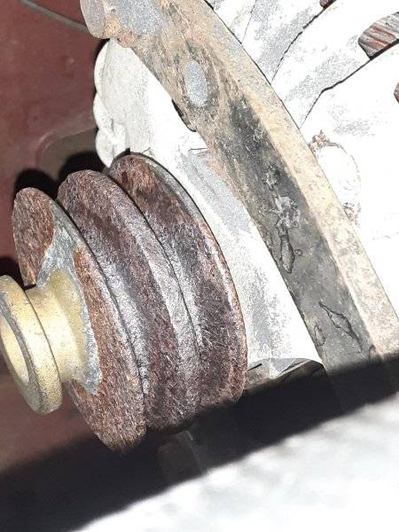

I took a scotchbrite roloc disc to the pulleys and they cleaned up considerably. I guess now I wait til the new belts show up. I just want to drive this thing and not worry it will strand me. Sheesh. Like asking for a balanced budget.

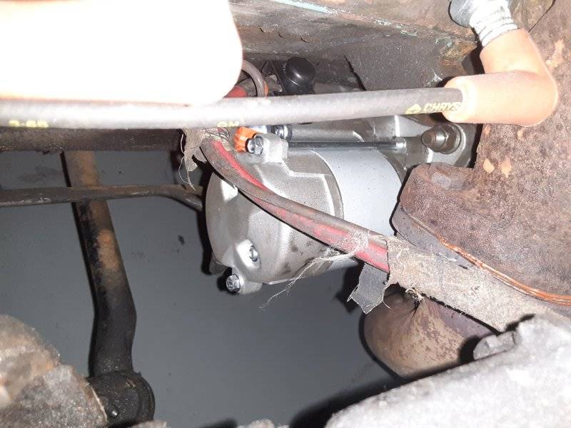

So today, my friend Neil was repairing the dyno's tach pick up cable, while I was working on a customer car. I had parked the coronet on the dyno's four post rack so we thought it would be perfect to test the lead and make sure it worked. I fired up the electronics and hooked up the lead. I got in to fire up the 500 and it cranked and cranked, then finally started to rumble a bit but didn't catch. I let off and went to crank it again and nothing but a click. Starter sounded terrible when it was cranking and now it was smoking. Called Oreilly and new starter was 107, not hateful. It came in at 3 and I picked it up. Took it out of the box and it was one of the late model high torque mini starters! We got the old one off and tried putting the new one up in. I was skeptical and it just would not lay flush. I searched on here and found a guy talking about this and he mentioned taking off the electrical terminal adapter, so I took it off and damned if it didn't just slide right in! Got the electrical hooked up, and installed the starter. It went in flush and got tight. I hooked up the battery and jumped in and man! She fired right up like she never did before! Wow is all I can say.
Then, I thought, screw it, those belts are gonna fit. I took the bolts out of the alternator and hooked the 63" belts up onto the alt and other pulleys and the 2 of us fought that bitch onto the bracket. Finally got them on, torqued the crap out of the belts and tightened all the hardware up, only to find out the fathead distributor cap wouldn't fit next to the alt. So out came the big boy pry bar and finally that pos cap went on. Belts look great and after running ac and revving it up a good bit, they are still snug. Had to gently bend the fan blades as some got flexed by the belts coming off. All good. Just waiting on a ps belt now.

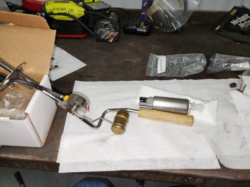

I ordered in a Holley in tank pump and hydramat sock for it. I'm doing mine so I can do my friend's 65 tank. Need to practice on mine.
Picking up solder, benders and the tubing tomorrow.
