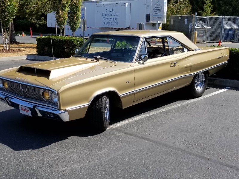

I put a scoop on my 67 coronet to make it look like a super stock car.
I like it. Love the color too. I think that is my car's original color. I mainly planned to try to make it look like the one I had in high school (which was silver, no scoop). I have already strayed from that plan when I decided not to run all the fender emblems. I also had stock rims with wheel covers back in the day but I am not going to stick to those. I might keep a set though just for the heck of it. What size tires and wheels are you running on yours? They look great.
15x7 in front with 225/70/15.
15x8 in rear with 275/60/15

Nice. I didn't think the 275's would fit. The more I try researching it the more conflicting information I find. Do you recall the backspace on those rear wheels?
5 inch backspace. I had to roll the inner wheel lip. And I also put in super stock leaf springs. Theres people that claim that size wont fit. But I used some wheel spacers to figure out what I needed, then had the backspacing redone on them. And the tires dont rub unless I turn hard.

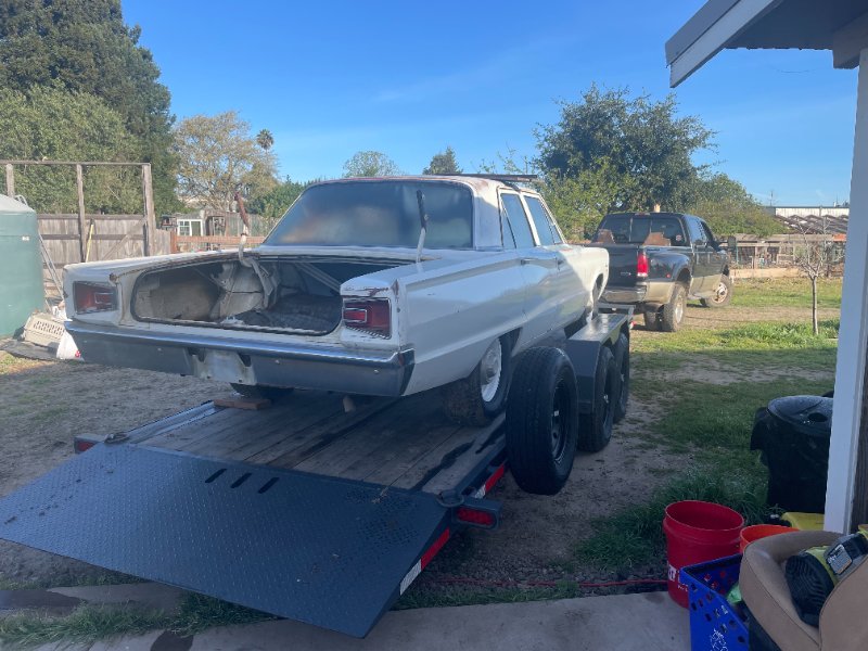

I keep looking. I did buy a four door parts car, but it is limited on what it can donate to the two door.
I already traded the trunk lid for a 66 console and two 66 buckets. The buckets are pretty trashed but the tracks are correct and in good shape.
I keep looking. I did buy a four door parts car, but it is limited on what it can donate to the two door.View attachment 2012510

What seat is in the front on the more door? Also, did that car get shoulder belts?
Rat infested, rusty bench. No on Shoulder belts on either. At least nothing left on the car to indicate that it had shoulder belts.
