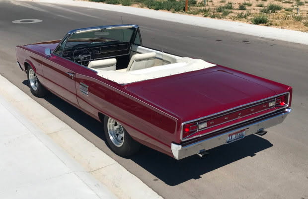

Morning Guy's, I do way more reading than posting but here goes. I have a 66 Coronet Ragtop. Oil pump died and took out my motor (was sold to me as a 426 Max Wedge w dual quads but turned out to be a bit of a Frankenstein build). Currently having a 440 built up (yes, I know, 66 didn't offer the 440 that year but wanted more horses than to be period correct). So. Question: I've decided to go with a clutch fan setup on a re-cored copper radiator and see clutches from $70 - $250 depending on the site. Will a $70 clutch fan do the same job? I'm interested in a mechanical thermostat option as well. Any info and suggestions on what/where to buy is much appreciated.

That... is an awesomely beautiful car !!!! Good choice on the setup, just be sure the clutch selected provides the proper spacing of the fan inside the shroud.
Beautiful car! Get a severe duty clutch fan & a shroud.
