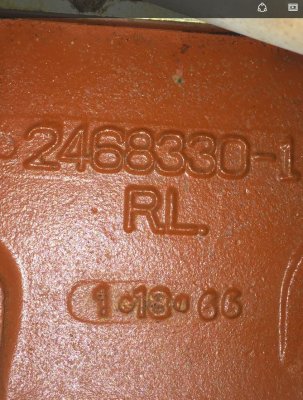

So the stamped data on near the distributor does not show the date, other than the B for 66 and H for Hemi. Is the pix below a good example of the casting date.
Yep. That's what your looking for.

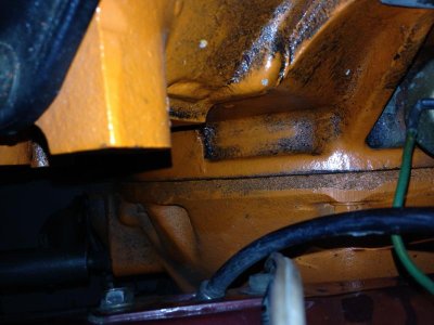

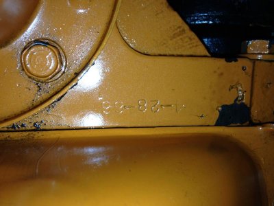

very interesting thread about your Coronet. I also just picked up a 68 charger with a November 67 build date. Trying to determine if the block is original to the car, I have found only the casting number and assembly date of the block. The pad next to the distributor has been cleaned off im assuming during a deck surfacing, so that is a disappointment. I was told my block is not original due to no being VIN stamped in the bell area next to the oil sender. It is very hard to get to the rear of the block when its in a vehicle to see any numbers, but mine may have a very light stamp of some sort but its just to hard to tell.

Vit C. Yours wont likely have a VIN on the block because it was built before Jan 1,1968. Som3 do some don't. And to muddy the waters more i remember something about no hemi blocks poured in 67. I may be wrong as i am no expert. I will see if i can find out more. Pull your starter off and check the casting date on the block behind it sometime.
Ive also read that no blocks were cast in 67, ill have to find the article, but it states the last known date in 66 and the first known in 68. My photo doesn't show very well, but I can get close enough to make out the 66 behind the starter. ill get it pulled off soon enough but im sure enough to not worry about that. My car was built (B03) nov 67 and the block assembled 4-28-66. I was told the block should have the 13 digit serial number starting with MN (Maryville) on the pan rail, but all it shows is the 4-28-66. Gilach, I hope this helps this discussion, does your block have the 13 digit serial number??
Look for MN or MV followed by 426. The next four days would be a julian date and the next four would be the sequence number. Look on the right side above the oil pan rail on the side of the block. Like i said...not an expert...still learning myself. There will be no numbers on the motor that match any numbers on the car until sometime mid production year 68, and there is no solid date on that either.
