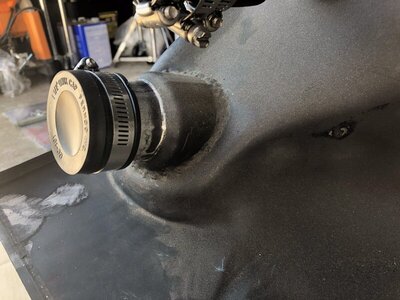

i ended up chickening out on my 66 Coronet fuel tank grommet setup an did some welding to eliminate it after a fill-up fuel gush experience
