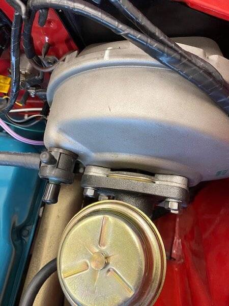

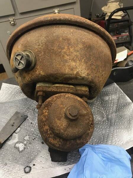

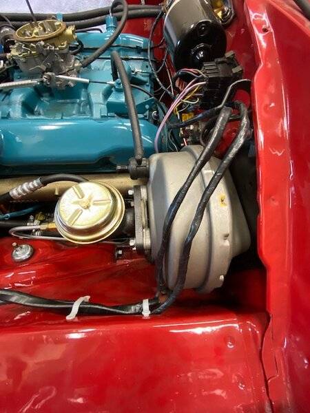

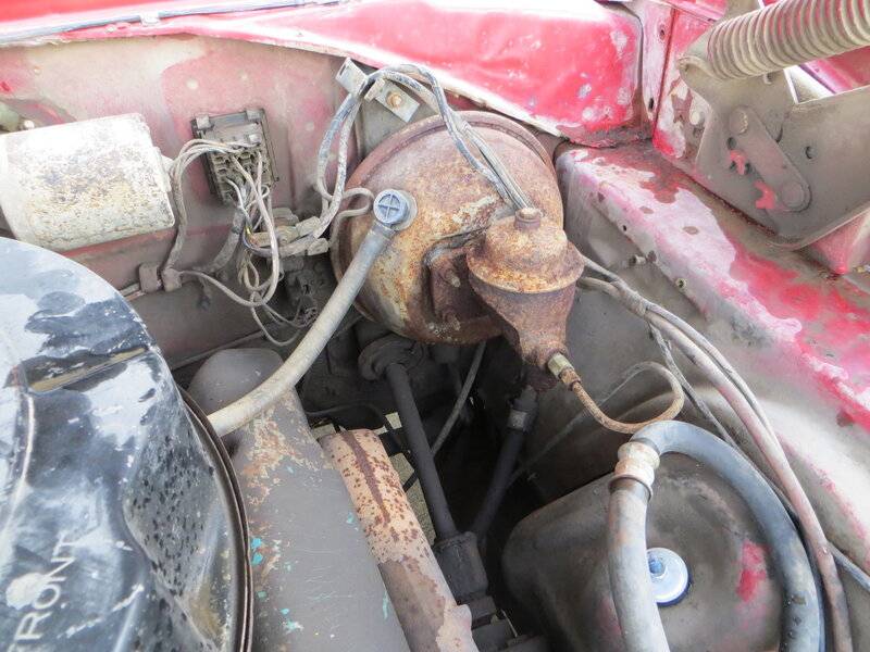

Hi Folks, I was "admiring" my work on getting the brakes bled on the car (we still have work to do in that department, grrr). I went back to look at the old pics and noticed that I have a slightly different Brake Booster now than was on the car before. So, the question.
The old Booster had a "Spacer" between the booster and the Master Cylinder. It is in two parts, one Alum and the other plastic, (you can see that spacer better in the "New" pic). Just wondering if that spacer is supposed to stay on the car with the "New" booster or if the Master Cylinder is meant to be bolted directly to the Booster in the new application? Here are some pics. Thanks, B.

The "spacer " you have is a part of the original power booster. It's the air filter assy. (see photo).
If the new booster needs something like it, it may be a different style and that's something to research. What manufacturer is the new booster?

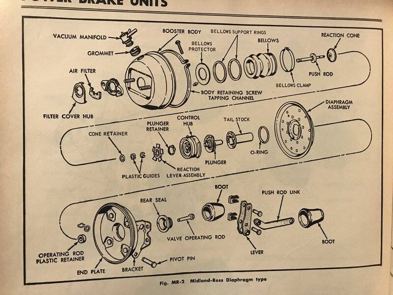

OK guys, I think I have it figured out. In the FSM it shows that there were three Power Brake Boosters used in 1966 on the Dart/Coronet cars. The one this car came with originally was the Midland Ross unit. It is on pages 5-19 of the service manual. That one requires and uses that "spacer" which is actually the air Filter Cover and Filter for the front of the unit. When I traded that one in, I was not paying enough attention to what I had with the comparison. I got back a rebuilt Kelsey-Hayes unit. It does NOT use the front spacer/filter. Instead it has an "air cleaner plate" on the font between the booster and the Master Cylinder which looks to be more of a Gasket, though probably not gasket material (my bet is it will be a steel gasket?) That explanation and how tos are on pages 5-27 and 5-28 of the FSM, if yours is like mine. The unit I got did not come with that "air cleaner plate", so I will have to figure out Plan B on that (figure 3, page 5-28). If anyone has any ideas where a feller can find one of these air cleaner plates, please let me know. The other unit that was used in 66 came from Bendix which is on pages 5-24 on the FSM. The Bendix procedure carefully goes through how to set the Master Cylinder Push Rod, as described in previous notes.

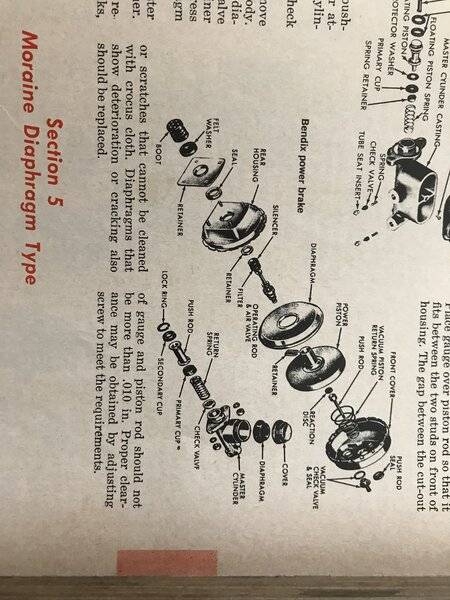

If you looking at your Booster, here is how you tell them apart on visual exam. The Midland Ross unit has "Clamp Band" that holds the Front and Back portions of the Cover Assembly/Housing Assembly together. The clamp band is secured by a screw and nut on the Band that is very visible. As well, it will have that easy to see "spacer/Filter Cover" on the front between the MC and the Booster. The Bendix uses Bolts/screws to hold the front and back portions of the Cover/housing Assemblies together. There are 8 screws that hold it together going around the Housing Assembly. The Air Filter for the Bendix is on top in the back portion of the Booster near the fire wall. The Kelsey Hayes is held together with Friction and is called the "Housing Lock" that locks the Front cover with the Housing assembly. There are NO visible screws or bands. The Air Cleaner is rather inside the outside Cover Assembly around the Push Rod. That is what I have.

Russ, this is the Midland Ross Booster. This is the one on the car when we started the process. Wish I would have gotten a new/rebuild one of these, it would have made the next step easier. Best, B.
Here are a couple of pics of the old Midland Ross Booster. You can see the Kelsey Hayes above, so only one left to see a pic of is the Bendix. Thanks again for the help and Best to you all, B,

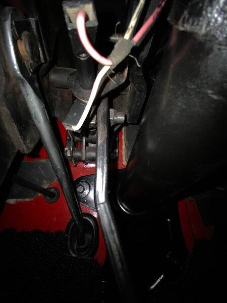

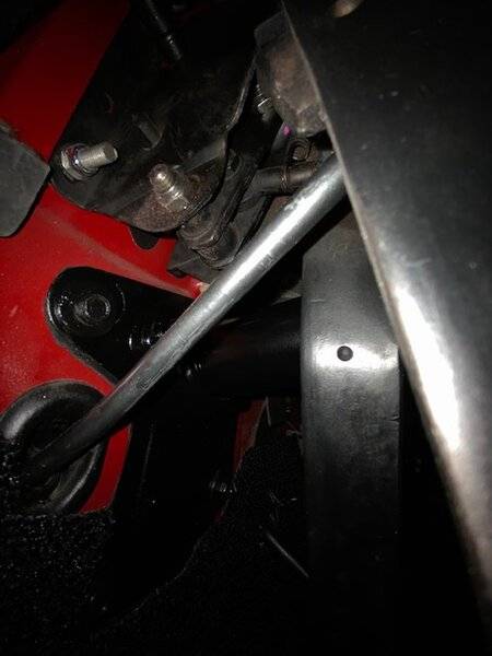

Ron, thank you for your questions. So, the KH booster needs only a "gasket" between the MC and the Booster, not the spacer and filter. My bet is it is a tin gasket that is needed on the KH, but I am not certain. So, I was hopeful to find someone that has rebuilt or has as a Parts Vehicle with the KH booster that would be willing to sell me the "Air Intake Plate" that works with the KH. What happened to you happened to me, when I got the KH, it did not have the Air Intake Plate. So, here I am, looking for an Air Intake Plate. Here are some Pics I just took of the Inside of car on the Pedal Assembly from side, front and then in the Engine Compartment. Hope that helps with the second part of your question?? Best, B.

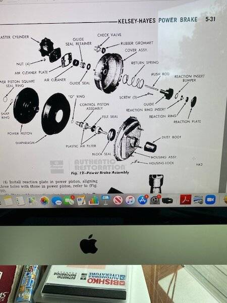

Hi folks, here is an exploded view of the Kelsey Hayes Power Brake Booster. If you look in the upper left side, you see the Master Cylinder. Next in the exploded view is the Air Cleaner Plate. I have read all there is to read on the system in the FSM and it does not say what happens if that Air Cleaner Plate is not installed. My bet is that it hampers the air coming into the unit. It really looks to me like it is a metal "gasket" type of piece. I have been online looking for this part and so far have struck out. If anyone has any idea where I might find the Air Cleaner Plate for this Kelsey Hayes unit, I would be beholden to you. Thanks in advance, B.
