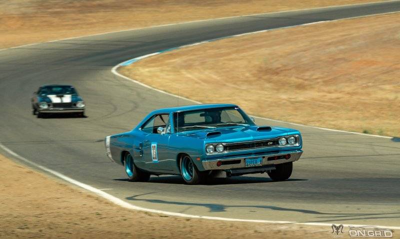

I’ve had pretty good success with my 69’ Bee out on the road course. I’m using stock style suspension with simple bolt on’s. Here’s a link to my build thread…
B Bodies and Road Courses - My Super Bee Setup
