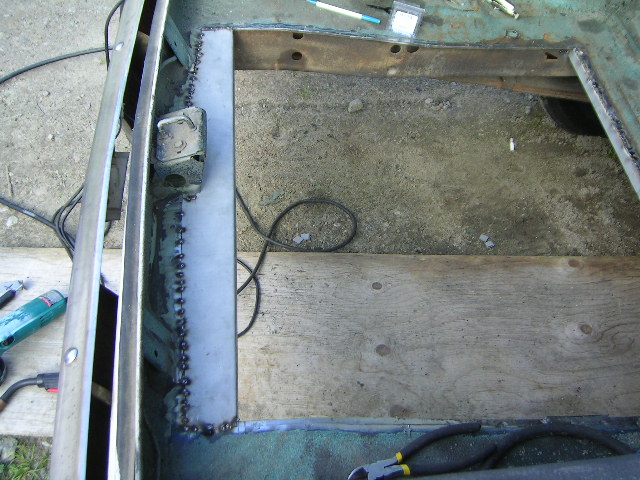

i sank the fuel cell into the floor of my 66, still gave me a lot more room for moving the springs in and i can still fit duals through the space where the tank was. for the front and back i welded in sheet metal angles to attatch the filler at the back and the box for the fuel cell in the front.i cut the trunk out on top of the inside of the frame rail so i would have a nice lip to attach the side fillers,i had a 2 inch lip on these that i cut so i could bend the sheetmetal to match the trunk contour. after that i just dropped in a box that i made and trimed it to match the floor. was a bit of work but its very solid.
that looks really cool. seeing this i might not buy a new factory style tank and go with a cell. thanks for sharing. but its really hard to cut an original cherry trunk pan. i,m still on the fence on this one.
