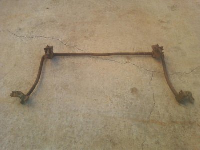

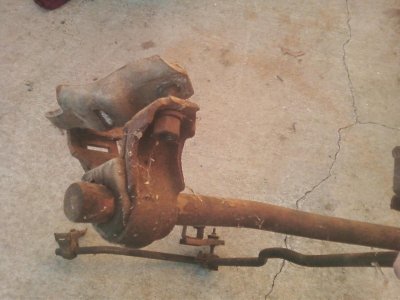

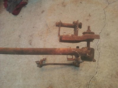

Can anyone send me a photo or diagram of what a 66 Hemi Belvedere II sway bar and installation look like? finishing my restoration and the sway bar is missing. Thanks
I have one that came on my 383 car. The sway bar ends clamp to the lower control arm strut rods unlike the 67 which bolts directly to the lower control arms. I will try to post a picture this weekend.

Thanks - looking for an all original restoration more than drag racing so any photo's/diagrams on how they hook to the srut bar and what they look like so I can try to find an original replacement would help - Thanks
Sorry for taking so long, Had to dig it out.

That helps! Any desire to sell it?
It's original to my car. I better not sell it. Thanks
Understand - thanks so much for the photos
There is a difference in front mounts on an early 66 and a late 66 B Body you need to know which mounts are correct for your car.
