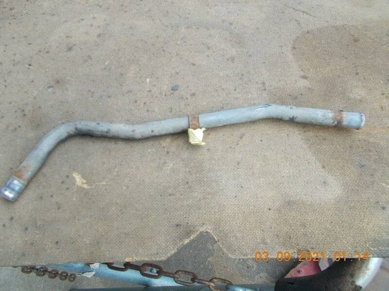

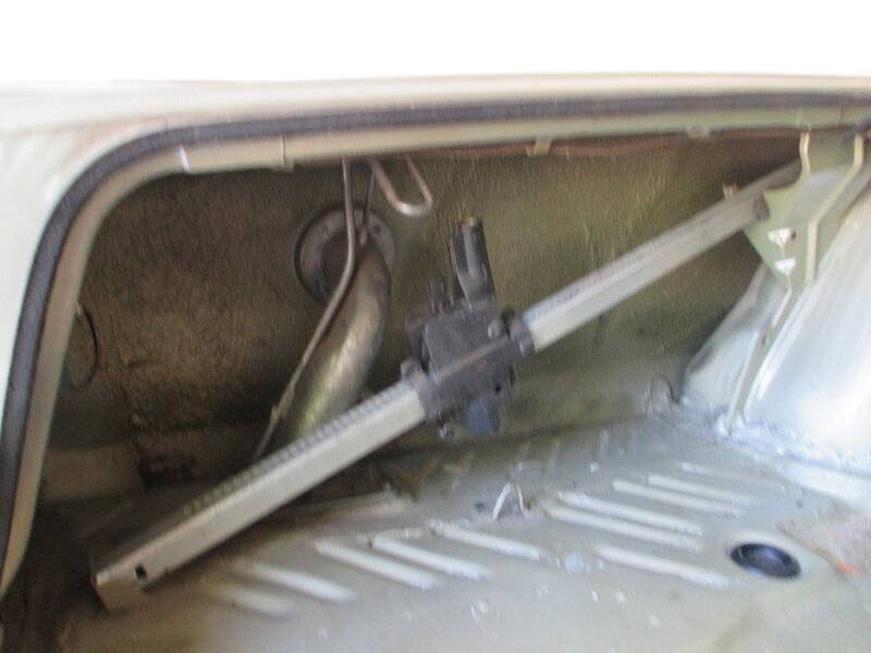

Just got my 66 Satellite and need to put in a new tank and want to make sure I order all that's needed. Car had a cell in it that I'm eliminating and going back to stock parts.
So I have to buy a tank and sender, hose kit from filler (looks kinda like a radiator hose and then two smaller hoses + clamps) a mat. J-bolt and strap.
All that's left in the car is the filler and vent tube so any other suggestions?
Thanks in Advance Ron

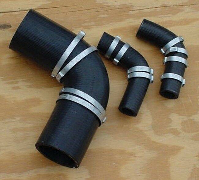

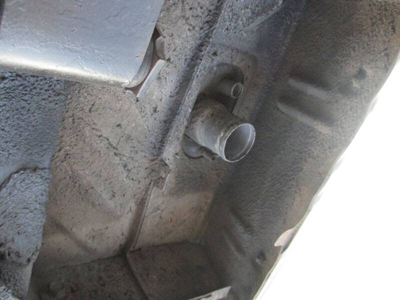

This hose kit is going to reach the tank or do I need another part?
There is at least three different suppliers of the hoses for the tank and the overflow to the various vendors. You will find a variety of reviews of issues with some of the hose kits.
The new tanks are slightly different than the assembly line tanks due to the smaller overflow tube. The original tanks used a grommet to seal the tube. The newer Spectra tanks has the tube soldered in place. The better quality hose kit includes this grommet, which you will not be needing.
The tank strap stud is a different profile unique to the 66-67 B-Bodies. It as finally been reproduced, thankfully.
As you mentioned, a new mat, tank, pad, sending unit, lock ring and ground strap will get you started. Either reuse an original OEM lock ring or search out one of the lock rings that we reproduce. The Spectra and other aftermarket lock rings are thinner and does not seal properly.
Yes, and there is a similar big one that goes between the large elbow and into the tank grommet.
