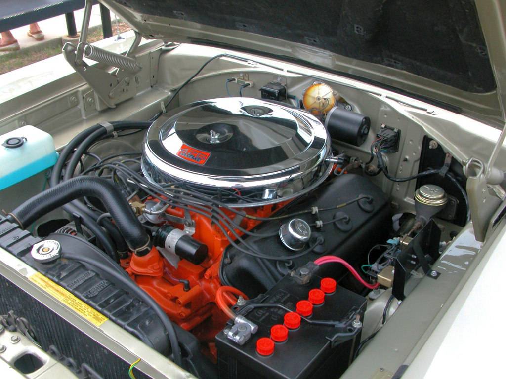

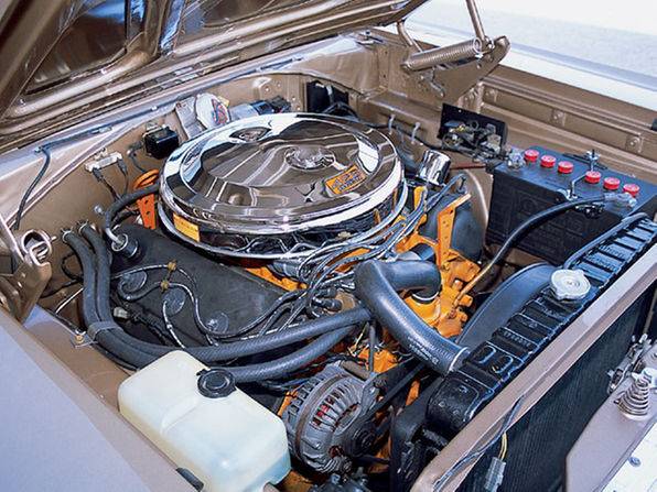

6-Plymouth-Belvedere-II-Convertible-426-Street-Hemi-Engine-Citron-Gold-Poly-_2005-CEMA_-DSCN5973.jpg
Also, will have the starter relay bracket on the driver inner fender in pics above
