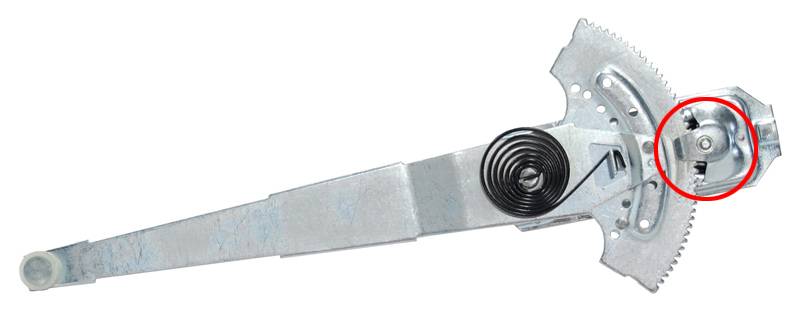

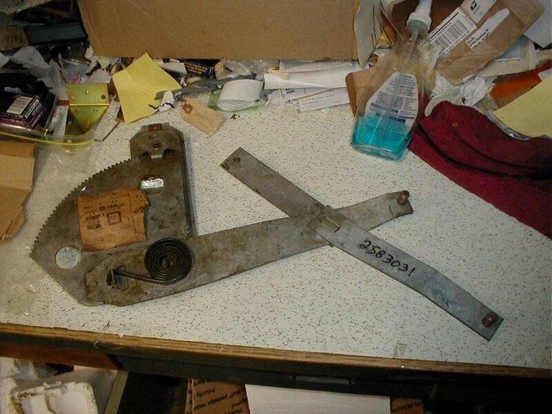

Sounds like the lift assist spring is broken ( coiled spring to help with raising the glass )
As far as years , I think the regulator is same 1966 thru 1970 B body

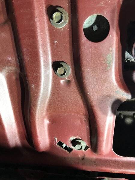

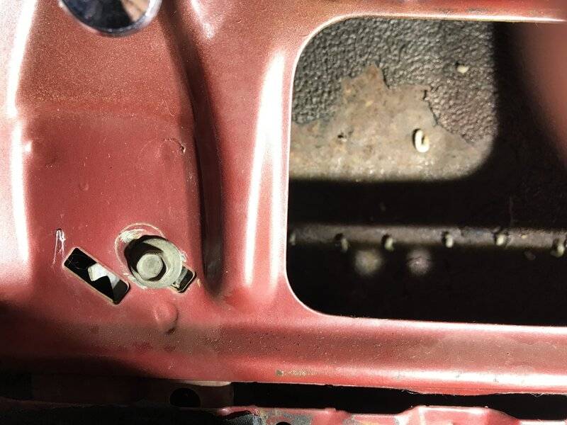

I was just working the driver's window, trying to figure out where the regulator is, and noticed that this nut looks like it wasn't lined up where it previously was. The bolt wasn't tight, so I lined it up and tightened it. Seems to have helped, but not completely.
The previous owner told me his previous owner had the car outside for the longest time w/o the doors on the car. IDK if the glass was in or not, but it seems like they're all out of alignment, if that's a "thing"!
Lift assist spring-is that something available new through the marketplace?

I just restored my regulators on my '66 Belvedere and it's a good thing I did.
On one of them I found the small gear that rotates the lift arm had a broken tooth and would skip when rolling the window up and down. Luckily I had a spare regulator that was fine. I cleaned off all the old grease and applied new white lithium grease to the gear and other moving parts. Just a guess but you may want to check the teeth on that gear. Otherwise, as stated above, the assist spring may have lost it's tension.

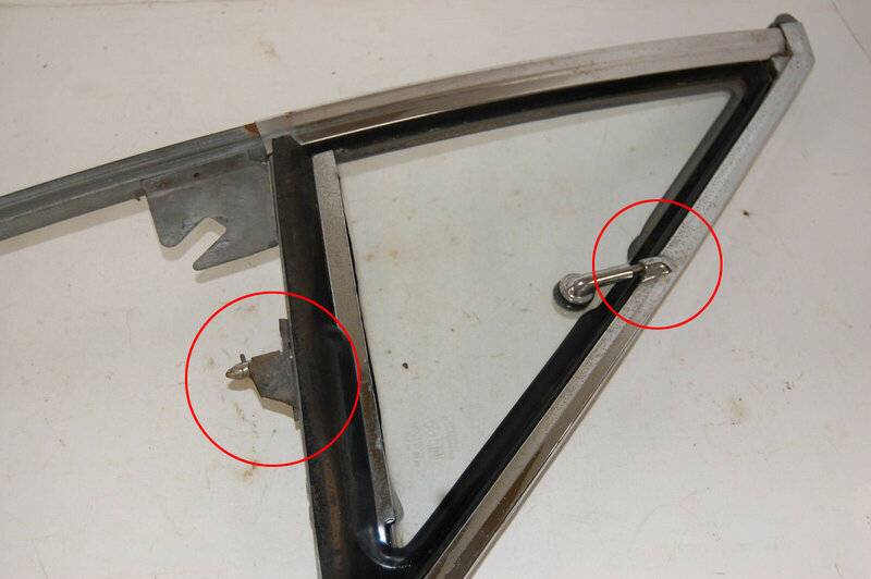

Regarding the vent window, I took the window out, cleaned the surface rust off the bottom pin that allows the window to rotate and now it works fine. Be sure not to really tighten the clamp that holds that pin. It will bind.
