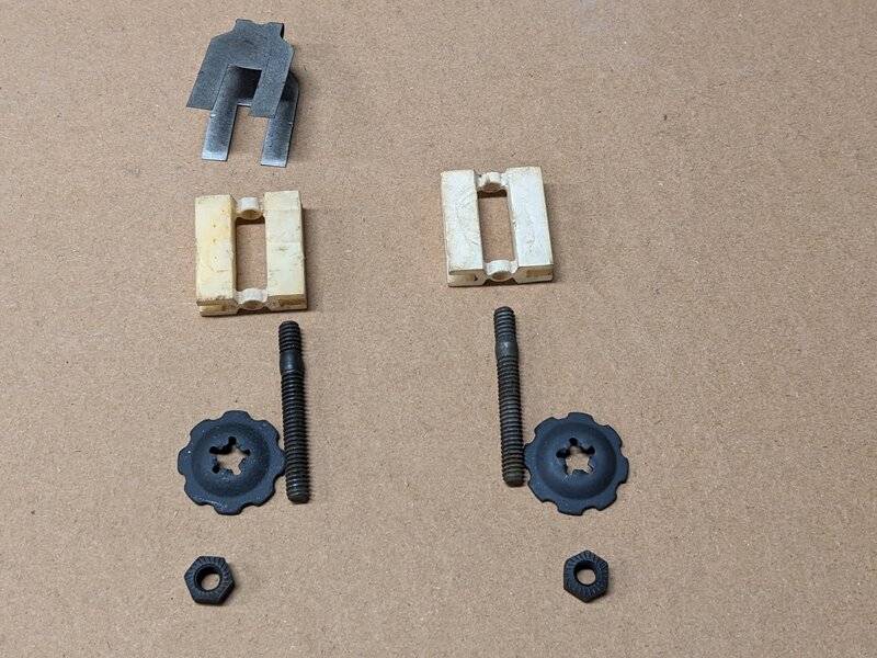

The stud, washers, nuts, spacers, and grounding strap is shown in the following image. The strap is used on later models. A ground wire is used in earlier models including 1967.

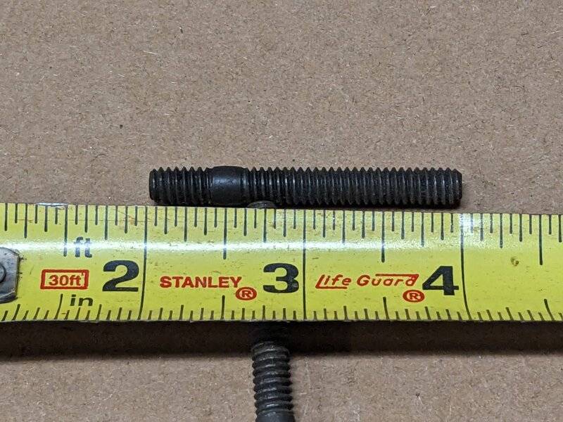

The stud is double ended with a thread stop portion toward the end that threads into the frame nut. The threads are 1/4"-20. The following image shows a stud:
