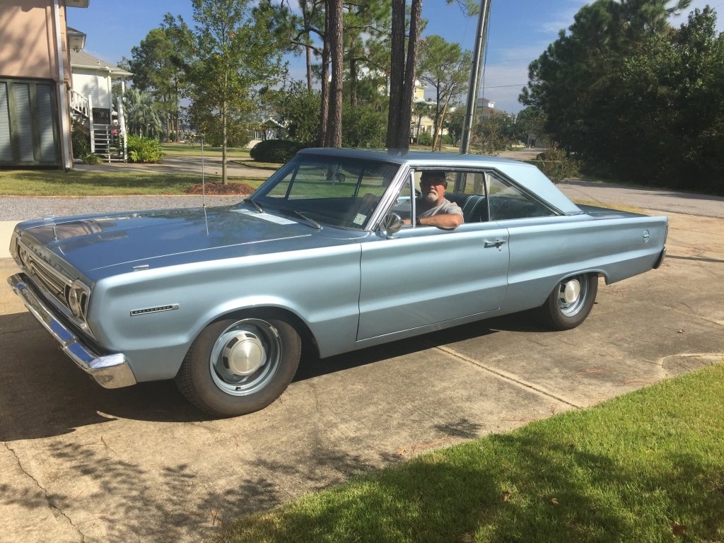

I don't have anything to add as it seems like you guys are on the right track...I just want to post and say you have a sexy ride. Love the color and look with the wheel/tire combo. :thumbsup:
