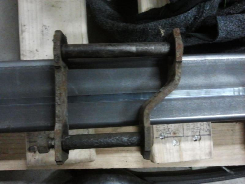

So I start putting the dana and caltracs in my wagon and ran into a problem. The old rear shackles broke during removal of the 8 3/4.
The original rear hanger does not bolt directly to the rear rail but actually off the the side. The rear shackle is offset inboard. The problem I have is I cant find anything but straight rear shackles for this car. The rear shackle for this car has a 1.25" offset. The largest offset I have found was .80 for an ebody.
Was wondering if anyone has any ideas.
Thanks
fix what ya have! Knock the pins out and put grade eight bolts in!! fixed!!!
Just got done knocking them out. Was hoping to go back w/pins but since they are only available for the shorter length pin, bolts it will be.
Thanks
